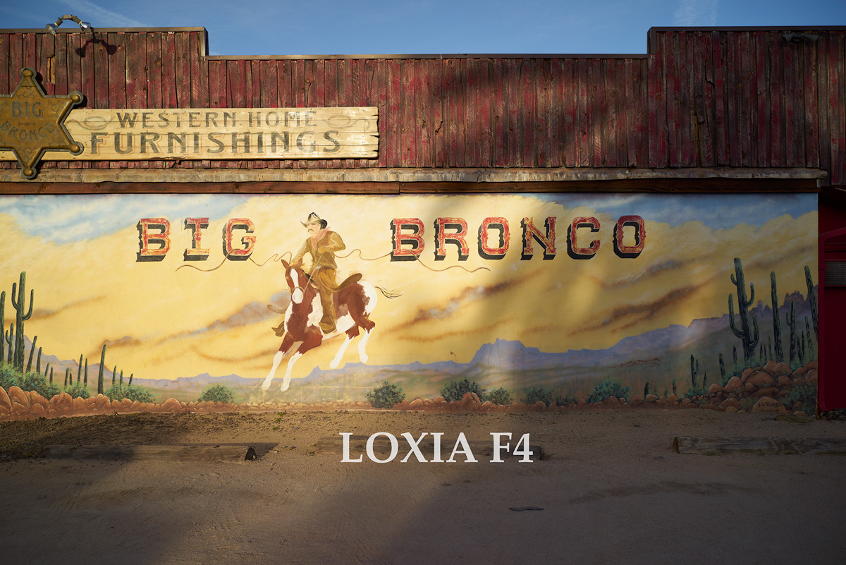

Full scene with the Loxia 35mm at F4. early morning tripod and 2 second delay all manually focused in live view with a hoodman loupe to make sure i am nailing focus. Im focused on the center like one normally would in most cases.

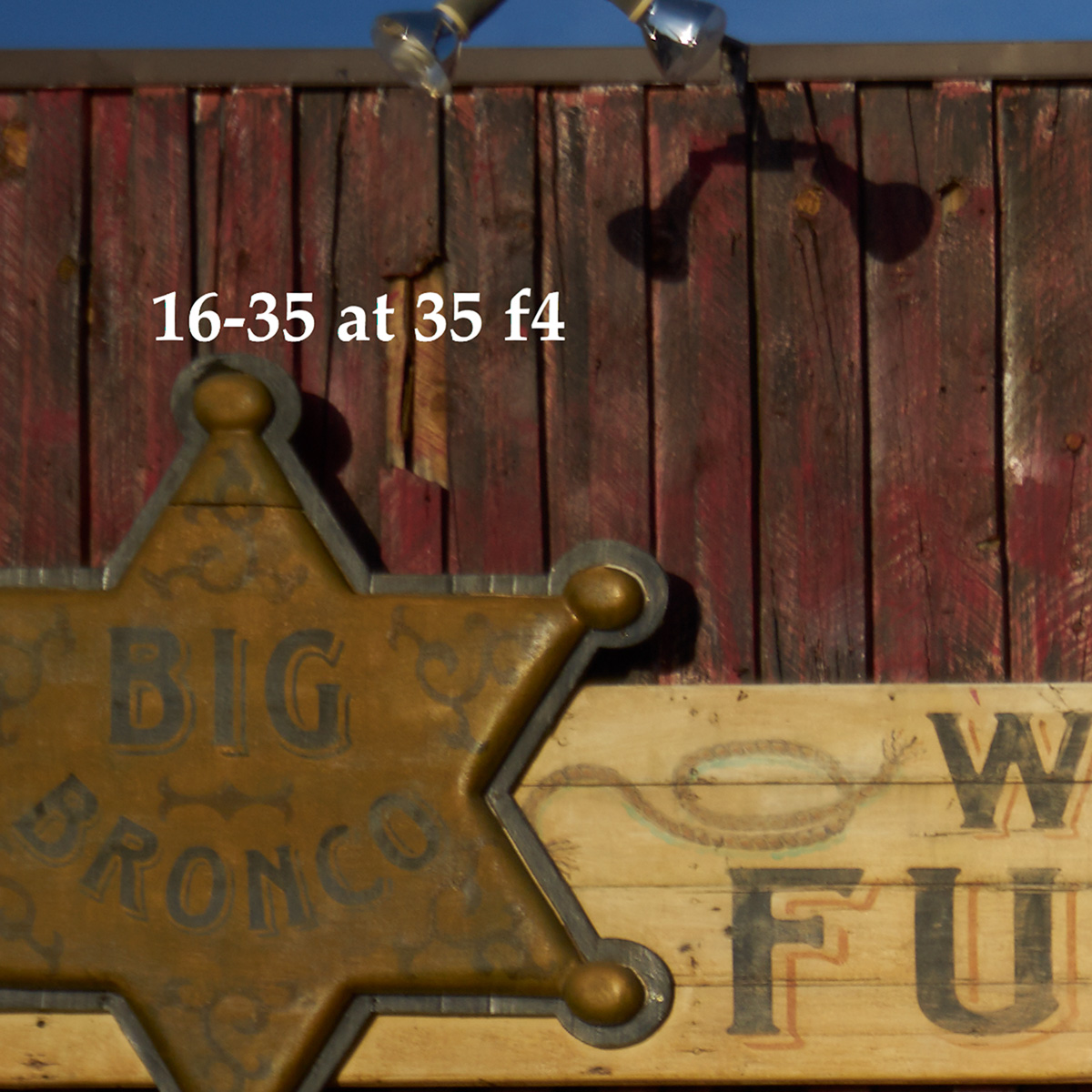

No lets do the upper left crop. Bonus I get F2 and F2.8 for free until I get to the zoom. LOL
Now here where the Loxia starts kicking in with the corners very well at F4
as you can see the Loxia just beats it up at F4 but again the zoom is wide open and really don't match the Loxia until F8 and the Loxia is at F4

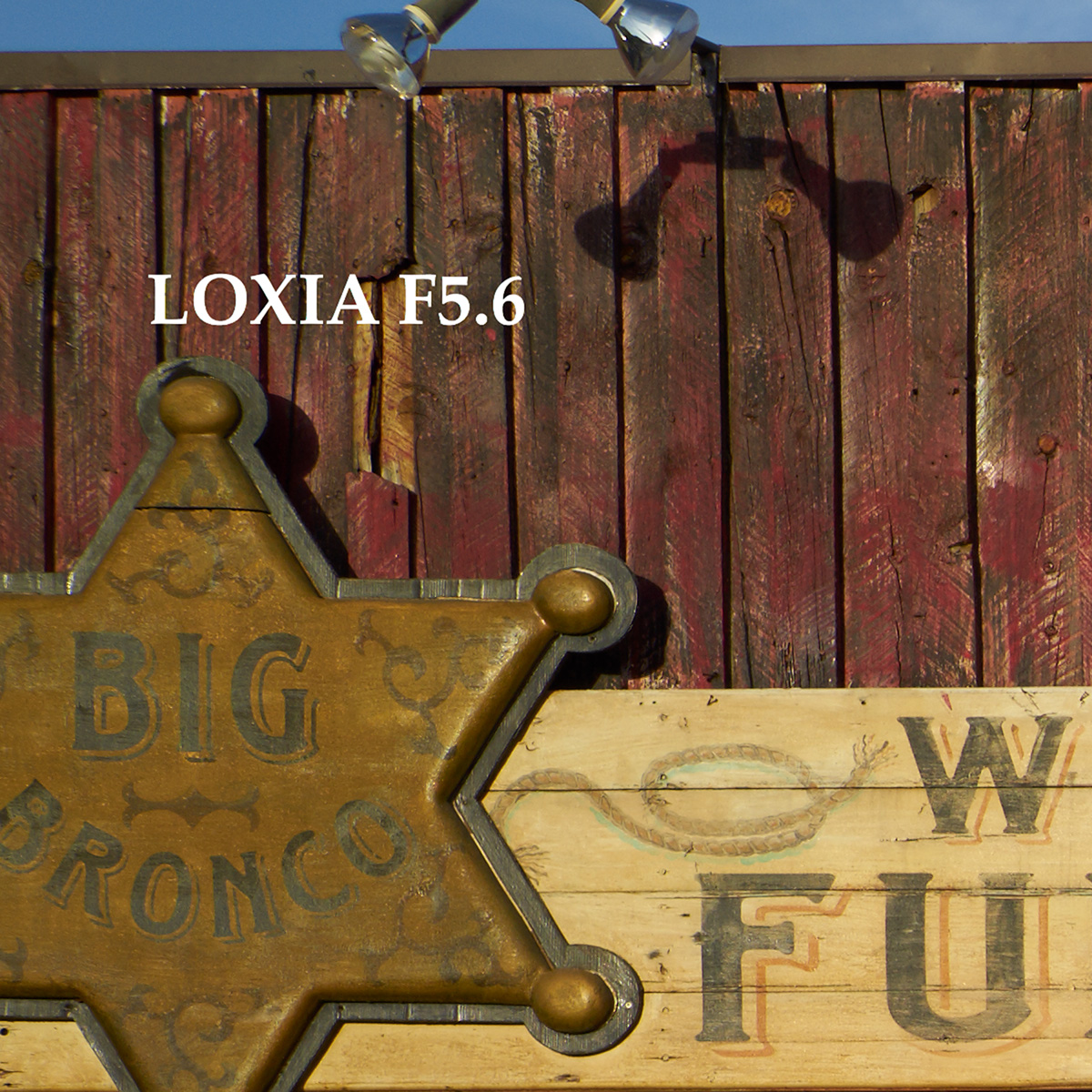

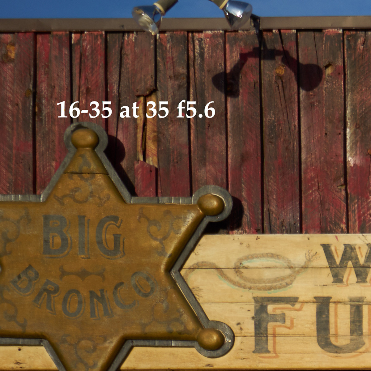

Lets move onto 5.6 where the Loxia is pretty much not going to get much better. This is very very good here

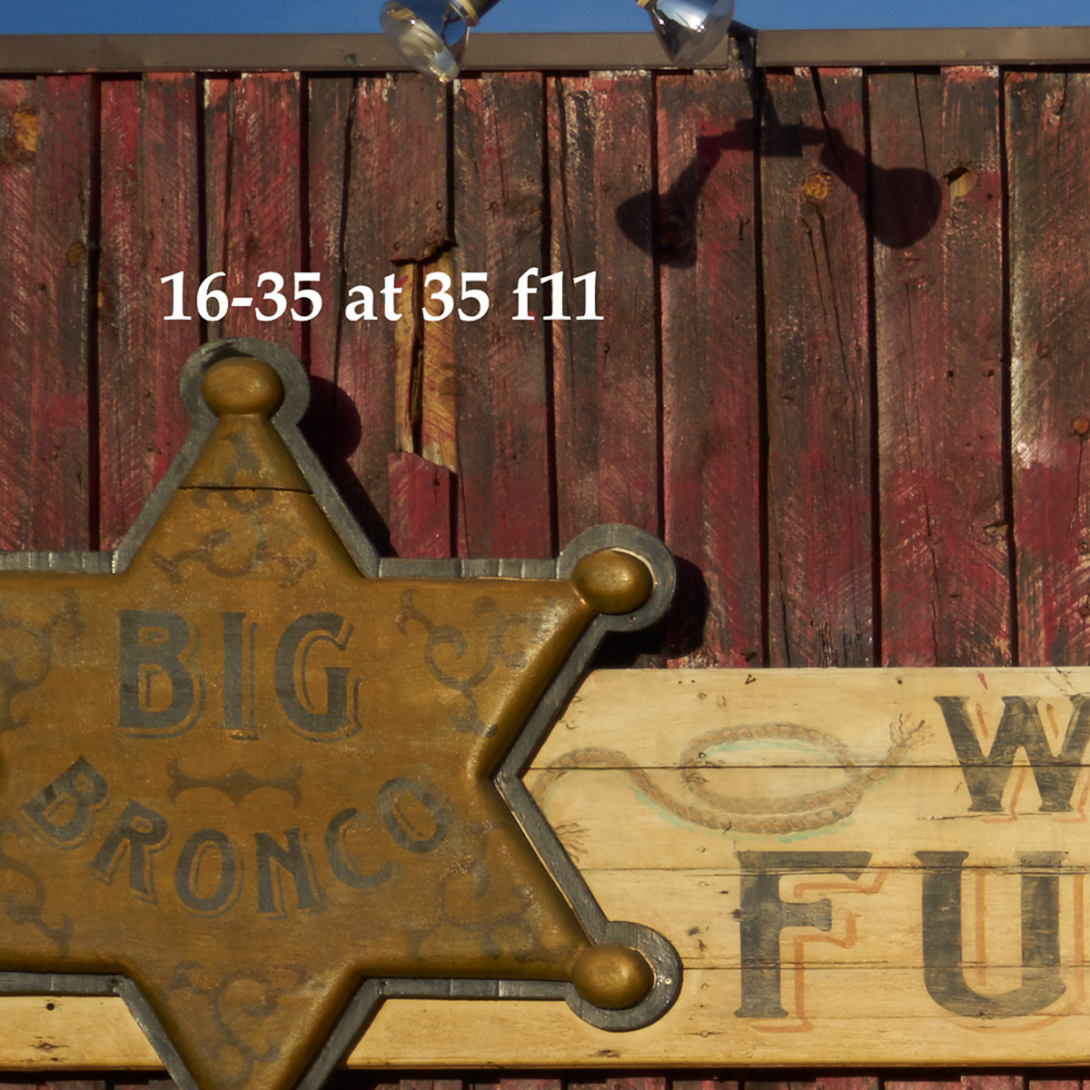

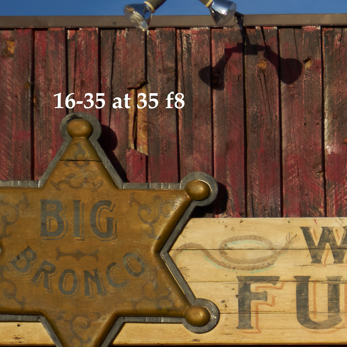

Now the zoom finally hits it at F8 and very good at F11

Even at F11 the zoom is not matching the Loxia. Maybe defraction who knows but the Loxia is certainly a winner at F4 and actually not that bad even at 2.8. I actually call that good as we don't always go here in reality with corners on some subject matter.
