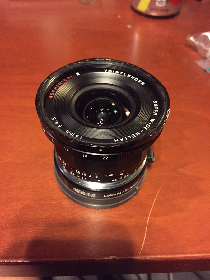

I bought the VC 15mm III a little time ago and I love this lens on the A7RII body but what always bugged me was this fixed hood. The lens itself take a 58mm thread but its buried inside this hood and a little tough to deal with. But more important the hood really has no effect outside of maybe protecting the lens element. Which is great but I really do not want it and want to use bigger filters that match my Batis 25 and 85 which are 67mm. I want a new combo of hood because i rarely use front lens caps as i always have my hoods on. Less caps to deal with but I also want to use 1 size ND filters , Polarizers or graduated filters so 67mm will work on all three lenses plus anything smaller than 67mm with a step down adapter .

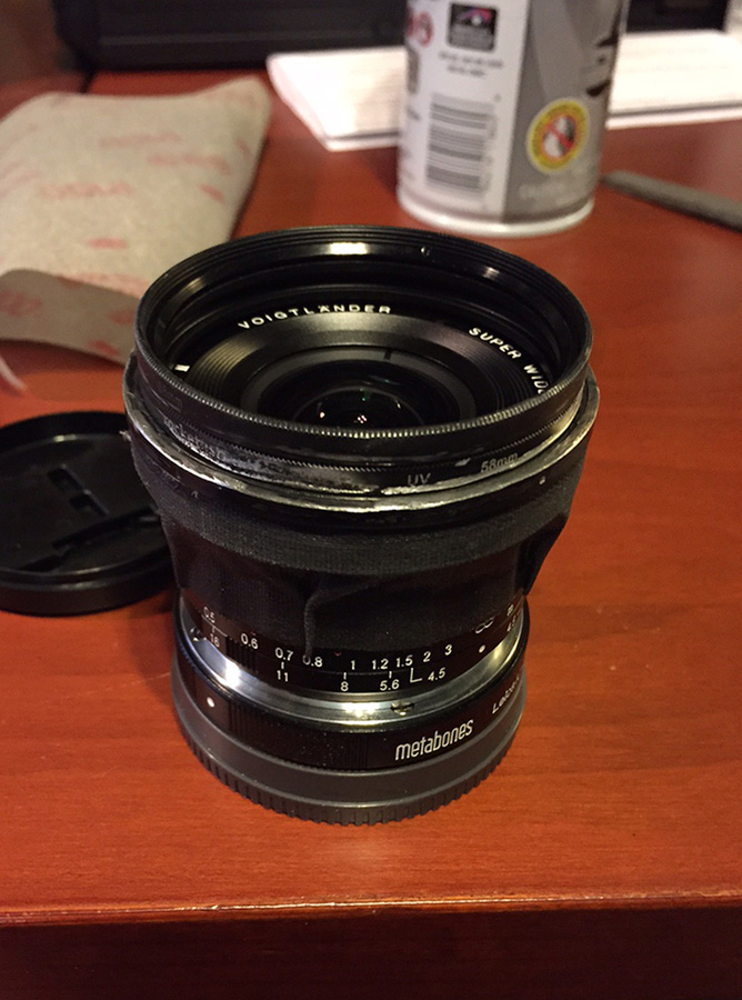

So in prepping the lens I taped everything off and I had a old lens cap that I taped down to protect the glass and the filter threads . Than I used a Dremel with a cut off blade and just cut each petal off. Now as far as this setup it worked but I have a better idea which I did after the cut . Get two 58mm filters get cheap ones they will get ruined. But screw in two filters throw a lens cap on and you can cut right to those filters without any damage to the lens filter threads and the glass.

But if your going to do this look at this and I much prefer to see folks use this idea instead as its much safer on the cut , the grinding and the wire brushing.
So just imagine the Petals are still in place here
Notice the one filter thread you see under the tape having these two filters in place stops you from going into the glass area and protects the lens threads themselves. I did okay with the above setup but I recommend this more
Here you can see after the cut what the lens looks like and the setup
Where I got in trouble was with the wire brush. I had the two filters in place and lens cap which protected the lens itself but I did not put gaffers tape on the area where the white dot sits and when I used the wire brush it slipped to the sides and buffed it up . That was my one fatal mistake . So take gaffers tape right up to the cut than use the Dremel with the wire brush and if you slip than your only hitting tape. Its not as bad as it sounds. I just need to paint that now

So here is where I will repaint with the Matte paint, its just too shiny for me. See arrow that band around lens. This is my fault I did not tape that off when using the wire brush and I slipped.
