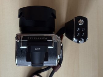

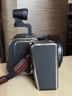

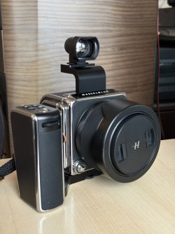

Yesterday the TTArtisan Optical Viewfinder arrived.
I think it fits relative good. The internal 35mm frame marks are not that much visible, they are opaque white.
Will try it in the field and report back.
Some quick iPhone shots, as promised:

You're welcome.
Yes, it fits well. When using it, my nose goes between it and the CFV-100c body. The cheek/mouth touches the display.
Please be aware that this is intended for FF 3:2 sensors (24x36mm), the frame marks are not that visible and it's a 3:2 frame for a 35mm lens on a FF camera, which more or less corresponds to the 45p's view on the CFV-100c. So, you should imagine the real scene crop to be photographed as extending above and below the marked frame to reach a 4:3 proportion. A bit of imagination when framing is required :).
Moreover, it does not have a center cross mark.
Another hint, my one fits very tight. Be careful when extracting the viewfinder from the hot shoe, I have the feeling that the the bracket connecting the foot to the barrel is a bit weak, it could bend and come loose from the barrel. So, just push/pull from the foot or the bracket rather than from the barrel.
