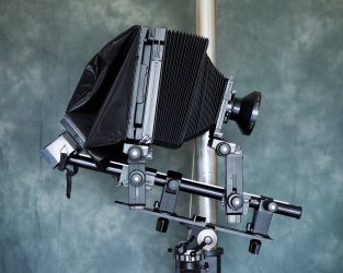

I had both for a while. My P2 was 8 x 10 (with a 4 x 5 back as well) but same general principle. The P2 is far too heavy and clumsy to take out of the studio. Actually,what @Alkibiades says. For inside, though, they are both good. As I recall, the stock P2 on a single rail clamp flexed too much so I used an extention rail with two clamps. That made it even heavier.

It was a long time ago. As I recall, the monolith was a more rigid alternative to a field camera. The P2 was something else entirely. For example, the picture above shows a Grandagon 200 on the P2. I could not begin to imagine mounting it on a Monolith. But I could barely carry that camera/lens configuration across my office. It also needed one of the bigger Fobas. The little ones danced.
I only had the monolith on trial for a while. Sent it back and kept the P2 because I didn't go anywhere I couldn't wheel a studio stand.
