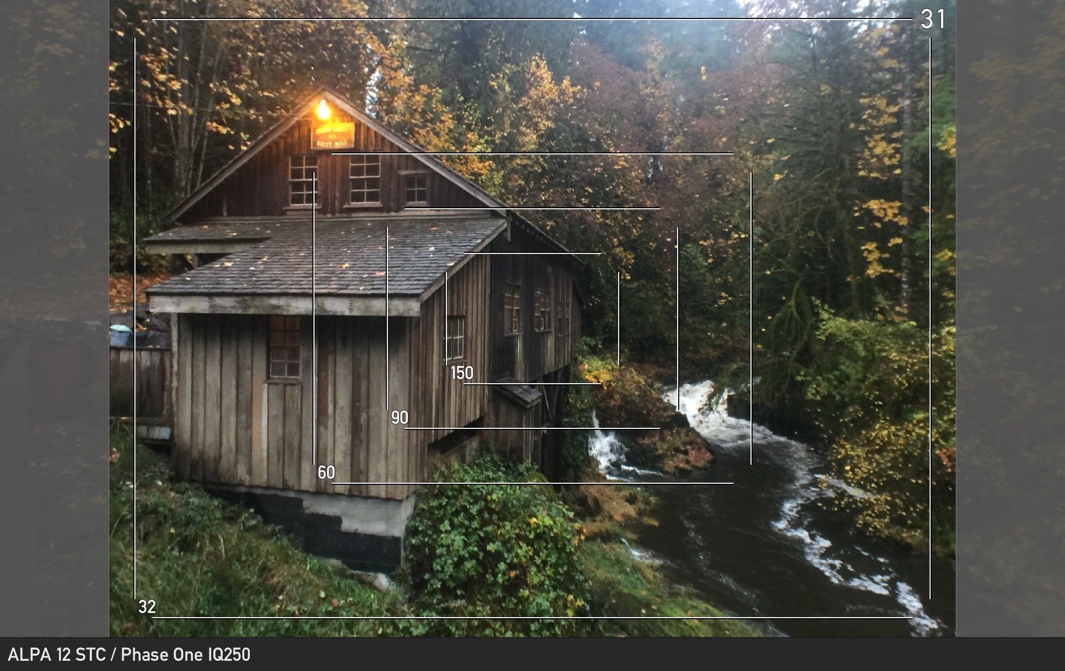

Here's an example from today without the movements:
