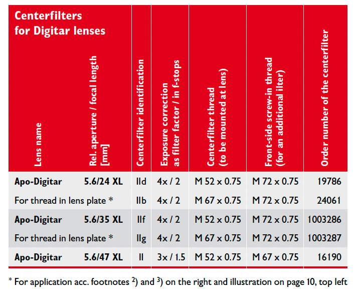

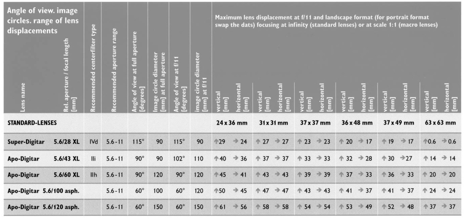

There are certain specific changes Alpa/Schneider made to some of the lenses I hope get memorialized. For example, center filters. The Alpa versions had a unique filter thread size for the 43xl and 60xl so the IIj could be used on the 47mm but also both the 43 and the 60 with the supplied adapter. I am pretty certain this is different than what Schneider says in their specifications. Here is the Schneider brochure for the "original" apo digitar lenses:
Here is the info from the "new" apo digitar lens brochure:

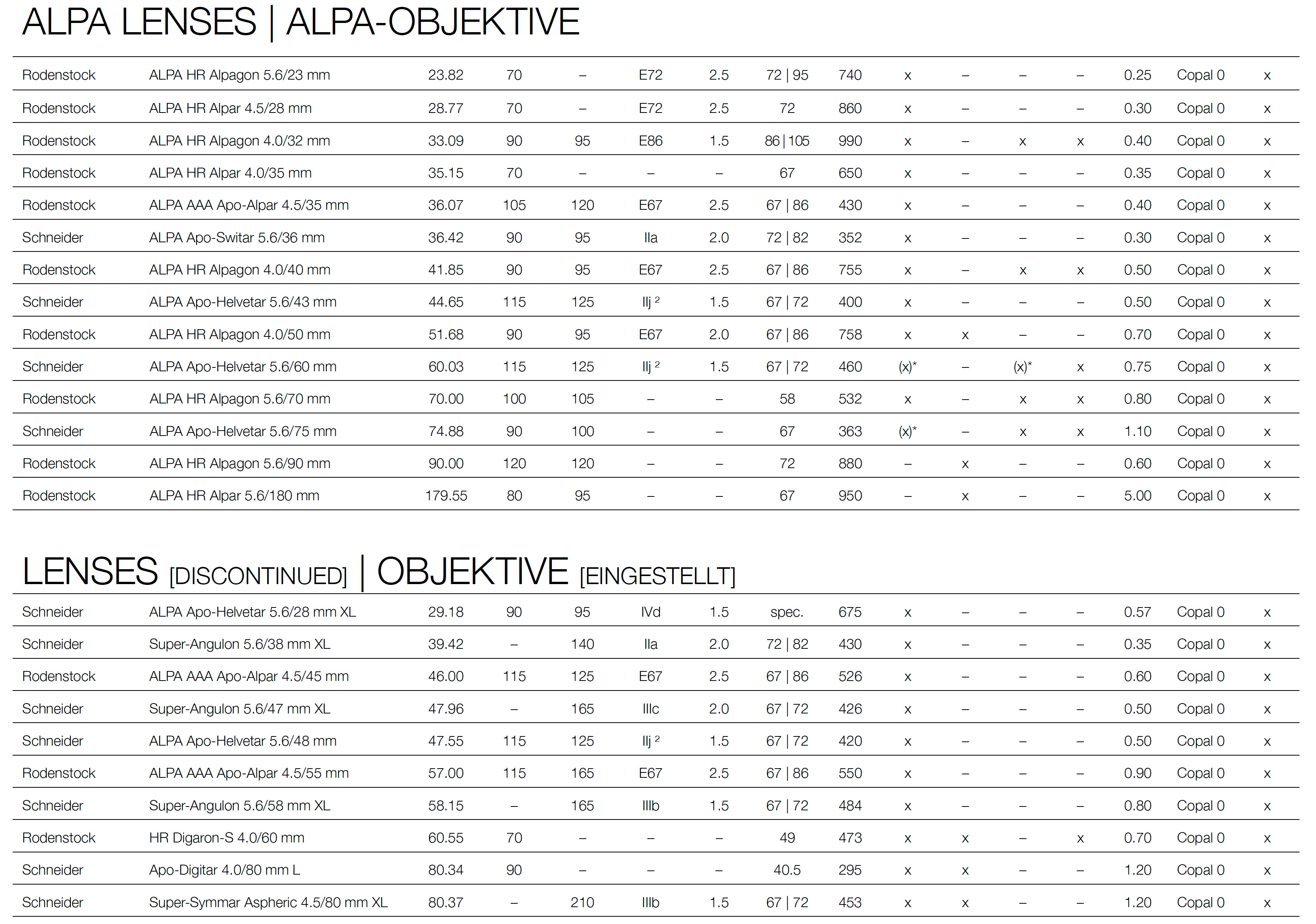

And here is the info for Alpa's version of those lenses, which comes from Alpa's brochure dated October of 2018. It shows using the CF IIj for the 48 (really the sk47), 43xl and 60xl:
So if you have an Alpa version of these Schneider lenses and don't know any different, you could unknowingly buy the wrong CF. It is all quite confusing. Not to mention all the confusion around the 47xl to begin with. Alpa lists them both, but changed the description of the new one to the 48mm! Ugh.
Edit: Front threads on the Schneider brochure vs Alpa brochure:
43xl: 58mm vs 67mm
60xl: 62mm vs 67mm
43xl: 58mm vs 67mm
60xl: 62mm vs 67mm
