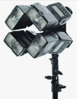

I have no idea if any of the Nikon Speedlights are powerful enough for your purposes. There are mounts that allow you to gang up 4 units if neccessary. Plus, they offer automatic functions with the camera.

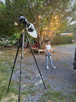

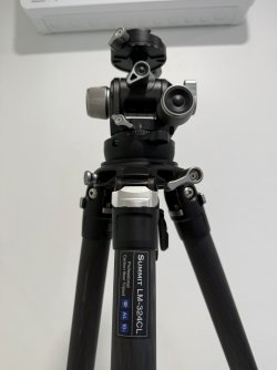

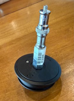

My new setup...........works great
Leofoto LM324CL 2m 20cm tall
And keep using the Profoto B1 Head...........very sturdy and lighter than my normal light stand
