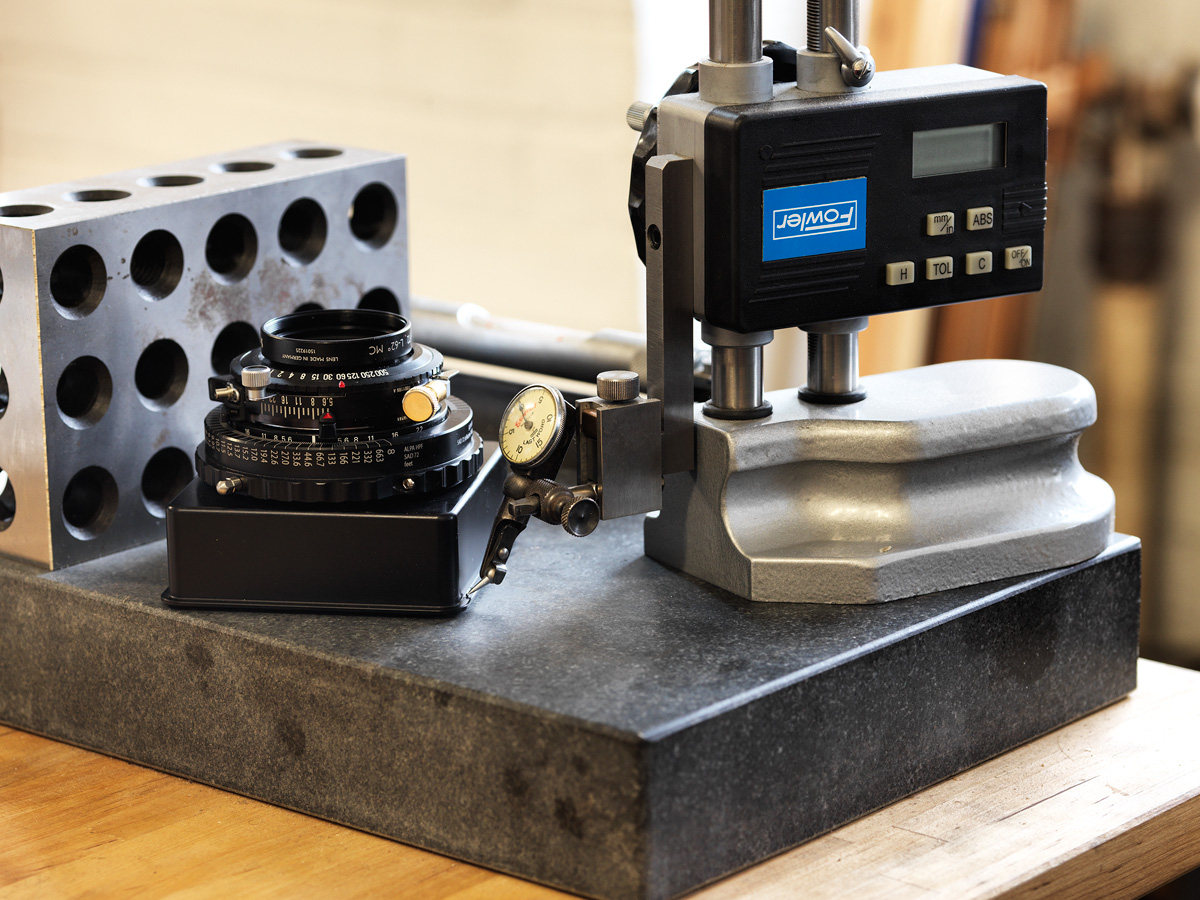

starting to monkey around in the shop with an alpa mount SK72
205FCC/120 macro/CFV-50c
jlm
was able to spend some time over the weekend and made a lens "board" for the Actus that will accept a standard Alpa mount lens. Using the 72 shown above. With this fitted to the Actus using the stock lens board mounting, you can fit any alpa mounted lens, leaving the focusing helicoid attached and functional as a redundant fine focus (distance scale not usable, of course.) will be investigating how wide a lens will work, but so far, it looks like the 28 will work,
next go will be same thing but for a standard Cambo WRS mount lens, a bit more difficult than the Alpa, surprisingly.
will show some pictures tomorrow
