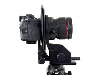

Hey everyone,
I'm using my Canon TS-E 24mm and 17mm Shift lenses on my Fuji GFX 100s II with the Viltrox Pro Adapter (v1, I think).
This works great, since I only need aperture control and EXIF, no autofocus.
There's only one annoying detail: I like to use Focus Check (MENU → G AF/MF SETTING → FOCUS CHECK), this makes the magnified (zoomed in) view pop up whenever I rotate the focus ring on manual lenses. This works great, e.g., with my Fuji 30mm TS Shift lens. But with the Canon TS-Es, as soon as this function is activated, the magnification view ALWAYS pops up, even if I don't touch the focus ring.
Have you experienced this problem? Do you know if it's the same with other electronic EF-GFX adapters?
Unfortunately my experiment with the Viltrox V2 (EF to E) on my A7RV did not work. I had aperture control like 30% of the time. It kept losing connection. Glad to know it works on the GFX version.

I also found this feature to be very useful with the GFX100 II, though I encountered the same issue with adapted lenses.
As a workaround, I configured the rear command dial to trigger the magnified focus assist when pressed. I have actually found that I prefer this workflow.

Thanks! Which adapter brand are you using?
Recently I switched back to FF and am currently using the Sony for architectural work. What I was using with the Fuji is The Fringer EF-GFX Pro. The lenses I used were the 17 tse, 24 tse ii, and 50 tse. The adapter was bulletproof. I really liked that it has an aperture ring built into the adapter.

For architecture I’m using a Sony A7R V. It provides more than enough resolution for my deliverables, gives me a mechanical shutter for flash interiors, integrates cleanly with the Pico, and works well with Canon TS-E lenses designed for full-frame coverage.
On the Pico I’m using:
– Canon 17 TS-E
– Canon 24 TS-E II (also in crop mode for ~35mm equivalent)
– Mamiya G 50 L (custom mounted)
The 24 handles roughly 80–90% of a typical shoot.
This is purely about client workflow. For personal work I still use the CFV100C on the Pico with Schneider and Rodenstock lenses, and occasionally for architectural exteriors as well.
It wasn’t about one system being better — just aligning tools with how I’m working right now.
No, I’m not using the Arca 24 or 50.
Another forum member mentioned that RAF made him a Canon TS-E to M39 adapter, which is what I’m using. The shift mechanism has to be removed for the adapter to mount properly, and the aperture is preset beforehand. You don’t have the same on-the-fly aperture control as with the Arca lenses, but in my case that isn’t a limitation, as I’ve always worked at f/11 for architecture.
