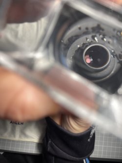

I wiped over it two times but I guess there are tiny scratches on the lens.
This what I got back from the camera shop…
I did a quick check and I can’t see it on the images…
Rod S.
Are you saying that you gave the lens to the camera shop to fix the shutter and it came back with this mark on the lens?
The mark on the glass might be an abrasion into the coating, or it might be a deposit of some substance that is resistant to whatever liquid was used.

Further thoughts to what I wrote above, earlier:
I don't see any 'tiny scratches', as you phrased it. I see a large elongate mark with a diffuse edge that has two or three clearer diagonal bands across it.
My best guess is that it's a fingerprint. That would be the simplest explanation.
Some fingerprints are gluey and resist removal but can be removed with the right approach.
Now, what to do?
There are numerous foreign particles visible on the edge of the lens and on the painted exterior. (SK didn't leave them there. Where did they come from?)
If you use a cloth, some of those particles will, unavoidably, get scored across the lens.
(In addition, cleaning cloths get put down on surfaces, where they collect grit.)
First, before anything else, use a blower to remove the loose particles.
If a larger particle won't blow off, it likely has some sticky substance on it. I would gently nudge it loose with the pointy corner of a sheet of tissue paper.
With the visible particles removed, I recommend that you wet a cotton bud with YOUR CLEANING LIQUID OF CHOICE and rub the tip against the mark. Just the mark.
(I've used acetone safely for years, and for fingerprints it works well and better than anything else I've tried. But I'm careful. You use what you want.)
Use multiple cotton buds, each newly wetted. As you do, examine the mark and judge if the mark is becoming smaller. If it appears to be coming off, great.
Using this approach, I have over the years removed a number of marks that I initially thought were permanent.
I did not ckeck the lens in the shop, so I dicovered the mark when I corrected the cover of the ring for the time adjustments.
I spoke to the technican today and of course he said this was before and I said no. So we are in 1:1 postition. I asked him why he did't say this when he discoverd the mark, but there was no answer...
He also said that he did't close the cover because for "good" because he did't repair the spring.
Well (or actualy not), but talking with him is over for me.

I never spray (Zeiss lens cleanig fluid) directly on the lens. I spray into the air and move the lens through the mist.
What I did so far:
I always try to blow off everything with a hand bellows. I also avoid to use liquids for cleaning the sensor. Never used pressured air.
The Q-tip is a way to big for this tiny lens and tiny mark. It cover almost the whole lens. It would be too dangerous to touch the painting around the lens.
I used the edges of my sensor cleaning swabs with aceton. It kind of worked out ok, it is smaller but not gone completly. I stopped working on it because I was running out of unused swabs and also I don't want to do too much. And of course it leaves some traces on the lens. So cleaning the whole surface of the lens with a lens cleaning liquid was necessary. If I look through my magnifying glass I can always see some dust or whath ever, I am not in cleanroom here. But it is better than before.
Thanks for the suggestion to use aceton and also for the warnings! They are important!
For others reading this tips, warnings do's and dont's ...
Everything here is up to your one responsibility. There are alway different opinions. For example: "I use a micro fiber cloth..." vs. "don't wipe that lens with a cloth".
This is not a criticism. It is a warning that you can realy damage your lens with al this above when you are not carefull.
Now I can think again about the main spring of the my copal 0...

This sounds like good progress. I'm sorry to hear about your problems with the technician. That's always frustrating.
If I understand you correctly, applying acetone made the area of the problem smaller. Scratches don't get smaller when you apply acetone, so it sounds like there's a substance on the lens that you were able to partially remove.
Seeing that you're comfortable using acetone, another step you could consider is applying a drop onto the affected area and letting it sit for five minutes before carefully wiping it up carefully. If it is a solid, crusty material, just be careful about wiping. Instead, try gently absorbing the acetone and residue. Were I do this, I'd practice applying a drop onto a flat glass surface to make sure I could put a small, controlled amount.
