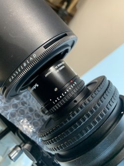

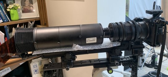

hasselblad 503cw
Just got Schneider Macro-symmar 120mm f5.6 0060 lens by Aliexpress from China which is optimised at 1:2 when aperture fully open.
mount on automatic bellow using 65mm to Hasselblad V adapter, captured by FUJIFILM GFX 100SII with Hartblei V mount to GFX adapter.
Test result is excellent, nearly no CA at corners and very sharp from central to corner. it is much better than Hasselblad S-planar 120mm f5.6.
I attached tests as below, edit with capture one without sharp, captured at aperture fully open @f5.6 1/125 Iso 40, light source with Elinchrom strobe
This lens is not expensive.
lens itself cost £270;
M65x1 Thread to Hasselblad V Bayonet Mount Camera Adapter Ring for Helicoids cost £21;
65mm-42mm M65 x1 To M42 X1 Female thread Camera Lens Mount Adapter For Helicoids £13
M65 to M65 Mount Lens Adjustable Focusing Helicoid 17mm-31mm Macro Tube9239 £24
V-M42 Lens Adapter For Schneider Lens V Mount Adapter to M42 £14
Schneider Macro- Symmar 120mm f5.6 is industrial 12k scan lens which have four editions optimised different magnificent. 0058 for 1:1,0059 for 1:1.45, 0060 1:2, 0061 for 1:3.

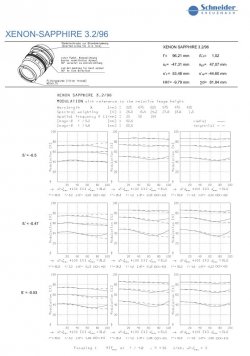

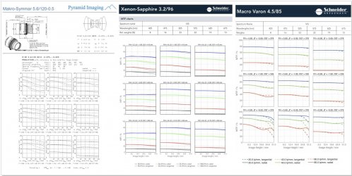

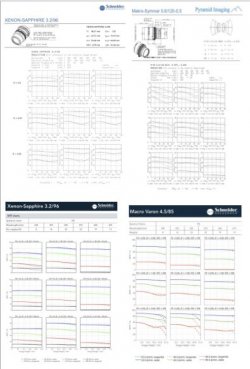

it is very strange, get two different MTF of Schneider Xenon Sapphire 3.2/96 0001 0.5X.
one has unbelieve 100l/mm 50% at central and corner;
I have not found 1:2 edition for sale with reasonable price. I will keep watching.
Just found a used Schneder Xenon Sapphire 3.2/96mm 0.5X lens, cost me £780.
When I digitalised medium format 6x6 film using 33x44 CMOS sensor, the magnification would be round 0.5X, So I choose the fixed 0.5X Magnification lens which optimised Mag is 0.47X-0.53X.
There are nearly four adjustable magnification macro lens. one is Schneider Macro Varon 85mm f4.5 0.2x-2x, Rodenstock Linos 105mm /f5.6 0.3-3x, Nikon 150mm printing f2.8 third edition, and another japan lens. The adjustable magnification lens can't beat fixed magnification lens at specific magnification, it beat it by convenience with the price of compromise between quality and convenience. So I choose fixed Mag-lens to do specific job.
The Schneider Xenon Sapphire 3.2/96mm has brilliant MTF achievement which shown 42.5% flat @f4 @ 100L/mm, unbelievable.
MTF chart please refer link as below
https://schneiderkreuznach.com/appl...79/SAPPHIRE_005_05x_V70_1071189_datasheet.pdf
