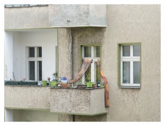

As said, out of curiosity I've just tried with my 907x and the CF 180.
A banal photo, taken from my balcony towards another balcony.
907x + CFV-100c | CF 4/180 | Hand-held at ISO400, f8, 1/320 sec in 14bit RAW mode - no IBIS of course

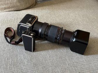

And this is how the whole setup looks like:
Thorkil
Thank you, no its certainly not a tiny construction with the adapter... :p
The balcony looks fine, but is it a tiny bit unsharp?
I would miss the IBIS. I will try with and without the Ibis, and see how wrong it can go.

Yes, it may not be 100% sharp, although I think it is when I see the original image on Phocus. Consider that I've been so "brave" to use 1/320 sec with a 180mm lens without IBIS, not even a 2x factor. :D
The goal however was not precise focus nor micro hand-shaking control, it was more to test how much rolling-shutter distortion one gets with a static subject. Not that much, but sometimes I get a bit of it.
Yes, it is a bulky setup, I don't use this setup hand-held usually. :)
