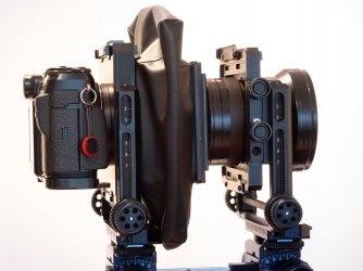

I first looked at the GX line because I wanted a 250mm lens for my Toyo VX23D and Fuji GFX 50R outfit. Large format 250mm lenses don’t work because the register distance is too long for the VX23D body (unless custom long bellows and rails are used). Good medium format SLR lenses in the 250mm to 300mm exist, but they’re too long and heavy for my setup. For example, I’ve heard good things about the SMC Pentax-A 645 300/4, but that lens weighs 1,360 grams and is not usable on my VX23D.
I nearly passed over the GX line because of the awkward lens housings, but then I stumbled across a picture by a person on Flickr (Nokton48) who removed the lens cells from the Fuji housings and remounted them in various scavenged shutters for use on his Plaubel Makiflex. Ah ha!
I started with the 250mm f/5.6, and now also have the 210mm f/5.6, and the 65mm f/5.6 – all rehoused and remounted for use on my Toyo VX23D plus Fuji GFX 50R outfit. I have excellent lenses in the 65mm range already, but I bought the GX 65/5.6 because I’m exploring tall vertical stitched panoramas that begin with the centre of the image circle and go up; I needed a large image circle for what I have in mind, and the GX 65/5.6 is the only lens I’ve found that has the image circle and works on my camera; large format lenses like the Fujinon SW 65mm f/5.6 do not work because their register distance does not allow the needed shift of 30mm or more on my setup.

To use the 65mm on my TOyo, I had to mount it in the centre of the front standard to balance the weight, which meant I had to build a special bellows mount that attached to the lens. This worked, but it's simply not practical.
