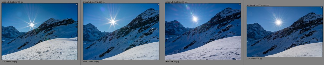

I have been exploring the "rainbow effect" which you see in these images here when shooting directly into the sun for years now.
They appear on all sensors from any manufacturer, more or less obviously.
When I aquire a new camera and / or a new wideangle lens, I'm always interested to find out how the results are shooting straight into the sun and how well defined the sunstars are.
Mind you, these examples are from a worst case scenario!
The front lenses were all clean.
To be able to produce this collection quickly, I opened all four images in LR Classic, although I use other RAW converters as well.
So please don't start comparing the colors of theses four images here, as I have not taken any attempt in equalizing them.
For me this comparison is purely about the rendering of the sunstars and the "rainbow effect", which some describe as PDAF-banding.
But for me that "rainbow effect" got nothing to do with the PDAF array on these sensors, as they also appear on sensors without PDAF, like Phase One backs and Leica M cameras.
From left to right (all at f11):
Hasselblad XCD 25mm V, XCD 38mm V (both shot on the X2DII), Fuji GFX100RF (35mm), and Tamron 25-200mm (at 30mm, shot on a Sony A7CR).
Sorry for also including a full frame camera with such a cheap lens ;)
Jost, I've never had this effect with a Phase One back, only with my Nikons and Fujis.
I am annoyed by these rainbow patterns, but I know that PDAF has a price, but also many, many advantages.
Are you sure you had that with a Phase One back too?

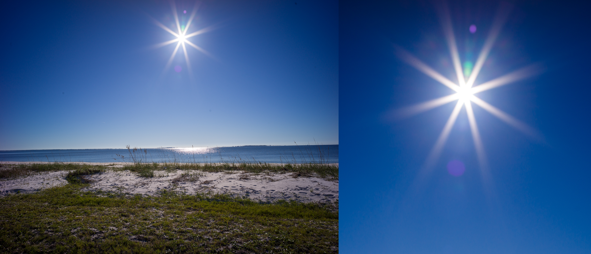

darr
PDAF aberrations typically look like:
  • Subtle striping
  • Grid or dotted patterns
  • Low-contrast texture irregularities
  • Often visible only after heavy shadow lifting
  • Usually fixed to the sensor geometry, not radiating from a light source
Lens Flare:
  • Bright, colorful, organic shapes
  • Radial alignment with the sun
  • Strong color saturation
  • Visible straight out of camera
  • Varies in size and position
It looks like lens flare to me.
I don’t know whether it is caused by PDAF or not but I haven’t seen that kind of effect from any of the digital cameras I have used (which I don’t think includes any with a PDAF array). I shoot into the sun very frequently and encounter all kinds of flare, good and bad.
Your image examples are quite interesting. The two X2D photos do show a regular pattern in the flare/sun rays but the GFX100RF example is noticeably more severe. I wonder whether this effect is exaggerated by the design of this particular lens?

Well, there is obviously some flare but we are talking about the regular pattern of red and green ‘stripes’. That cannot be a product of the lens alone but is presumably either a sensor artefact or, more likely, resulting from the lens and sensor combination. It’s not an effect I remember seeing with film.
darr

Darr: Thank you for your image examples and comments on PDAF aberrations and lens flare.
The XCD 28mm actually shows very little lens flare.
And the Hasselblad 907X has no PDAF pattern!
After Ben's question about the rainbow effect, I searched my archives: In fact, the rainbow effect only seems to occur with newer cameras and with sensors with PDAF arrays.
So not with Phase One backs or Leica M cameras.
I have crossed out my comment above in my post accordingly.
And this thread should mainly be about the Fuji GFX100RF anyway....

I’m not sure what your point is, Darr (or why you seem to be starting an argument)? Those photos show what I consider to be perfectly reasonable flare artefacts for a digital camera pointing into the sun. Jost’s example earlier has a much more noticeable grid pattern of red and green.
darr
I want to clarify my intent here, because I think it may have come across differently than I meant.
I wasn’t trying to argue against anyone’s interpretation or suggest there’s only one possible explanation. I was simply explaining why I personally read the artifacts in that image as optical flare rather than PDAF.
The way I approached it was by asking myself whether the artifacts would move or change if the sun were repositioned in the frame. In this case, they appear tied to the light source — bright, saturated, and radially aligned — which matches what I’ve consistently seen from lens flare and internal reflections in digital systems.
When I’ve encountered PDAF artifacts, they’ve tended to show a fixed, repeating structure tied to sensor geometry, which is why I mentally separate the two.
That’s all I was trying to contribute — not to pick an argument, just to explain the reasoning behind my conclusion based on my experience.

That's not a PDAF-artifact.
PDAF works in letting groups of pixels just see light from the left or right side of the lens (or the upper or lower side). So pair of two adjacent pixels works like the classical phase AF of a DSLR. Not that precise, but you have many thousands of these groups on a PDAF image sensor.
There are different implementations of PDAF. The most common is, to physically block the light, that comes from one side of lens. You later interpolate and recalculate the image so, that you don't see that pattern for the "normal light path". That digital compensation doesn't work, if the light shines steep from the side to the sensor. Than you can see PDAF-artifacts. Here is a good sample picture, search for "PDAF artifact" in that page.
The better way to implement PDAF is to use a double pixel structure behind each sensor picture element (Canon, especially the R1 is a brilliant implementation) or use Quad-pixel AF (OM System). So you don't block light, you can just read how much is coming from the left and the right. And for the image taking you sum up the two (or four) sub-pixel-elements.
Then you don't see PDAF-artifacts, just the normal lens colour cast as with a Phase One body. The drawback is, that you need two times the pixel (or four times in case of OM System)
What you see in the image above is the effect of periodic stray light. An image sensor is regular pattern of small elements (a few micrometer in period). Regular patterns interact with light and create something, that is called diffraction. If you use your blank image sensor to mirror a bright light source in a dark room, you can see that rainbow pattern around the mirror light source with your eye. Little rainbows (in case of a LED light). As it's a 2D pixel-structure, you see two directions of diffraction.
In that picture you have a brutal bright light source, hitting the sensor. A part of that incomming light is getting reflected back to the lens, another part gets diffracted back to the lens. And depending on the lens design, the coatings and so on, a part of that back reflected and back diffracted light is hitting the sensor again. To find the light paths, is very complicated.
You can omit this effect by using a well blacked pinhole lens.
With film instead of CCDs or CMOS you don't see such patterns, as film grain is not periodic structured but randomly immersed. Random structures create just a diffuse back reflection, but no rainbow.
The only solution I know (which works in this case) is to take two frames. One with the sun and one with blocking the sun.

It was always clear to me that the rainbow pattern in my extreme examples had nothing to do with the PDAF pixels.
