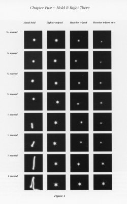

the 35mm film test - which focal length? 1/125 ist that fast and did it have IS? certainly did have ois ;)
This was before any kind of image stabilization.
Paraphrasing from Thornton's book, Edge of Darkness: It was shot with a Pentax LX and 50mm Pentax f1.7, 30 inches from the subject, on Kodak T-Max 100 film. Neutral density filters were used for some of the shots to enable them to be made from 1 second at f22 through 1/500 at f2 to give equal exposure to each frame. Although the exposure was equal for each negative, they were taken at different apertures, so the lens performance varies from frame to frame to frame. Small apertures show diffraction (the star around the highlight). Wide open tends to show a halo around the highlight because of uncorrected lens aberrations and extra flare. Exposures taken at the same speed and aperture are directly comparable as shown in the illustration. The conclusion is that hand-held at higher shutter speeds is better than slower speeds with a flimsy tripod.
