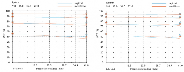

I can't speak to your point about "calibrated for the sensor". However, the MTF charts suggest both lenses do well across their 82 mm image circles.

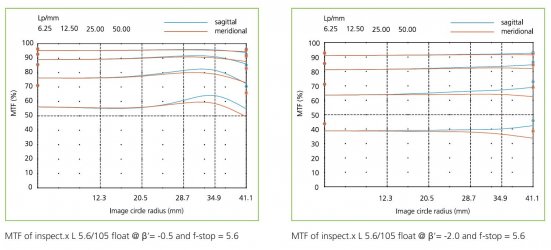

The Schneider Xenon Sapphire 3.2/96mm 0.5X has brilliant MTF achievement which shown near 45% flat @f4 @ 108LP/mm and 60% @f4 72LP/m with 62.5mm image circle,
The Schneider Xenon Sapphire 3.7/96mm 0.29X's MTF shown 50% @f4.5 108LP/MM, which Linos 0.3X shown 52% with 72LP/MM
which is better than linos
MTF chart please refer link as below
https://schneiderkreuznach.com/appl...79/SAPPHIRE_005_05x_V70_1071189_datasheet.pdf

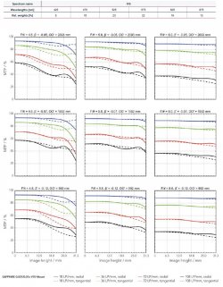

The Schneider Xenon Sapphire 3.9/95mm 0.23X's MTF shown 52% @f4.5 108LP/MM, which Linos 0.13X shown 53% with 72LP/MM

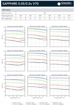

Here is the 0.5X Magnification lens MTF comparation between Schneider Xenon Sapphire 3.2/96mm 0.5X with
Linos 105mm f5.6 float 0.5X and retro fixed 2X.
Schneider Xenon Sapphire 96mm 0.5X shown 45% @ 108LP/M with Linos 105mm 0.5X shown 55% @ 50LP/M

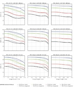

I am waiting Schneider Sapphire 3.2/96 0.5X and 4.5/95MM 0.07X posted from China.
The larger magnification the worst MTF chart. 0.07X is much better than 0.5X.
it has 57% @ f4.5 108LP/M

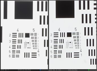

I just tested the 105mm Linos .76x in a film digitization test situation The sensor used was the GFX 100s II. I compared the Linos 105mm to the GF 120mm Macro without a macro adapter, with the 18G and the 45G extension tubes. We can read on paper how lenses react or perform but nothing beats side by side comparisons in a controlled environment. To effectively compare them I used the USAF 1951 transmissible 1X target printed on glass and can calculate up to 500 line pairs per mm.

The first image is the 120mm Macro alone and then with an 18G and a 45G macro adapter.
The 18G allowed the close focus distance of 8.75" and slightly improved the system's results. I was shocked to see how poorly the 45G image rendered. So I then reshot the 45G test with a new lens, a new adapter, and controlled the flare as much as possible. The results illustrate the best I could render with all of my changes and tweaks.

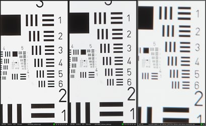

Now to compare the 120mm macro with the 18G adapter to the Linos inspect 105mm .76x side by side.
First thought was that the Linos lens can focus much closer to the subject.... but that is what a macro needs to do. The 120mm fell apart with the 45G never mind any closer.
