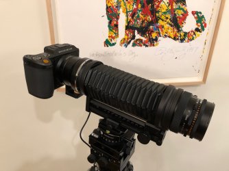

All this talk of macro and the Hasselblad lit a little bulb in my brain. "Hmm," I said, "I have a Leica R to Hasselblad XCD lens mount adapter, and a have a Leitz Focusing Bellows-R with Macro-Elmar 100mm f/4 lens. I wonder if the two bits are compatible?" So I assembled the pieces on a tripod and did some testing ...
Surprise surprise! The lens+bellows setup nets focusing from infinity to 1:1 and does not vignette on the 33x44 format at all! The bellows has a built in geared focusing rail as well, with a click-stopped rear mount to allow body rotation (for portrait or landscape photos), and of course the bellows' controls include a quick way to focus wide open and check DoF at the taking aperture. The only negative to working with this setup is that it only really works for relatively static subjects because you're depending upon the back's e-shutter. But modulo that, it works beautifully!
Gives new value to the Leitz Focusing Bellows-R + Macro-Elmar 100mm f/4 ... I paid something like $250 for that complete setup, in the box with the instructions, etc, a dozen or more years ago. At a time when nobody wanted Leica R gear at all anymore, because Leica had just recently discontinued the R system...

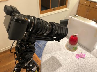

Hope you don't mind ... While we're on the subject of Hasselblad and macro, I saw this yesterday morning and had to capture it:
One of the orchids I keep on my dining room table has decided to grace us with a flower spike. These blossoms are about the size of a US quarter (or smaller) across:
Blossoming Orchid - Santa Clara 2026
Hasselblad 907x + Leitz Focusing Bellows-R + Leica Elmar-R 180mm f/4
ISO 1600 @ f/11 @ 1/90 sec
enjoy! G
Leica Elmar 180 f/4 Godfrey? I wondered if you meant 100/4. The 180 would be considerable in size, on the front of the bellows?
I tried with the bellows-mount Macro-Elmar-R 100/4 that came with the bellows, but it was too short to achieve the perspective and framing that I wanted. So I swapped the Elmar-R 180mm f/4 in its stead. It did just the right thing. I'd had some experience with this setup before ... although with the Hasselblad CF Sonnar 180mm f/4 and extension tubes, to wit:

This year I used the Fotodiox Pro Leica R to Hassy XCD mount adapter and the Leitz Focusing Bellows-R ... it's a bit more flexible as the bellows gives a broader range of focus settings and has the geared focusing rail built-in. Yes, the 180/4 is a bit larger than the 100/4 macro lens, but it isn't enormous and the bellows' lens mounting standard is quite robust. :)
