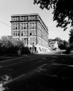

I have called this picture "RIP Danny". As I was photographing this abandoned foundry in Varndsdorf, Czechia, a Gypsy man of uncertain age came to me and questioned my motives for taking the picture. He said he was the “guardian of the building” and would call the city police if I didn’t leave. I calmly explained to him that I was fully within my rights to be where I was and do what I was doing, and offered to call the police myself, to clarify. Hearing about me possibly calling the police, the Gypsy man changed tack immediately and accused me of being racist and insensitive, for "not giving a damn that Danny had just died..." (whoever Danny was….). I offered my heartfelt condolences (still not knowing who Danny was) and agreed with him about racism being bad. He then took off. As we were driving away minutes later, we passed the Gypsy man walking by the side of the road. I rolled down the window and waved him goodbye. He waved back, still in a “rant” mood but now a bit more friendly. All right, RIP Danny, whoever you were.
(Linhof Technikardan 45S, Schneider Kreuznach Super Angulon 72 mm XL, Ilford FP4 processed in DDX and scanned on Hasseblad Flextight X1).

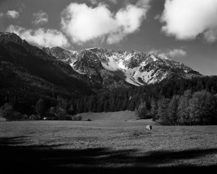

First snow of this year, and a solitary cow, on Mount Schneeberg, south of Vienna, on a beautiful early afternoon tomorrow. Shot on a Gibellini GP810v2 camera with 300 mm Sironar S, red filter. Fomapan 100 developed in DDX (1+4) in a JOBO 3005 Drum for approx. 9 minutes at 19 deg Celsius.
