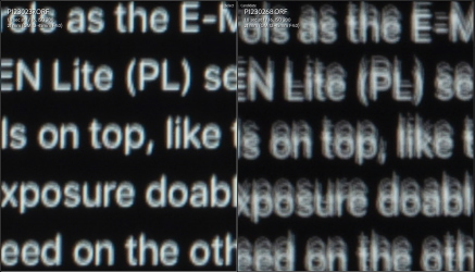

Attached is an extreme example of sharp on the left (1/125s) and very unsharp on the right (1s) Screenshot from Lightroom compare mode at 200%

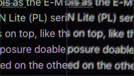

I've attached another screenshot showing the very best I could handhold at 1 sec, with IBIS On on the left, and my best with IBIS Off on the right. So IBIS is still having a good effect, even if not managing fully sharp shots.
