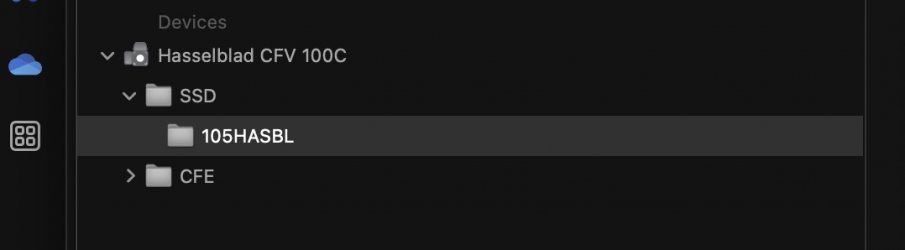

Edit: other forum members reported that by not mounting the digital back as "mass storage" and browsing camera images under the "Devices" area of Phocus 4.0's left sidebar it is still possible to import in FFF format.

I think that has always been the case. The difference in v4.0 is that having downloaded the 3FR files you can't then export them as 3fff files within the current v4.0 release. At least that is the case with my new X2D ii. The solution is that if you connect the camera but choose "skip" as opposed to "Mass Storage" you can export the 3FR files as 3fff files. Why on earth that works is beyond me. From early tests I cannot detect any difference in adjusting in Phocus 3FR files (which is now available) and adjusting 3fff files. Of course you then have to export as Tiffs if you want to edit in Lightroom or Photoshop. And you can't do that unless you download with the "skip" option.

Downloading images via USB-C:
when connecting a CFV 50C to a Mac running Phocus 4.0 it shows the two SD cards under file system AND under devices.
When importing from the file system, only 3FR files get imported. When importing from devices you get .FFF files.
That is different from previous versions and seems to be undocumented.
