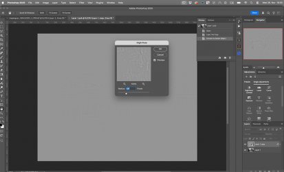

I have done it and see on the right following.
Is it right so me?

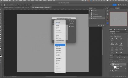

When the image looks grey, you can change the radius to make the outlines more or less prominent. This will regulate the intensity of sharpening. Regarding your second question, double click the two parallel lines with the little triangles in them. this should bring up a dialog where you can change the blending mode.
baudolino
Jochen, I am in front of my computer now. Look at the three images below. First image: change the radius to regulate the intensity of sharpening. Second Image: change blending mode to make the image look normal again, not grey with outlines. Third image: I have circled where you need to double click to get to the dialog shown in the second image. It is worth noting that your file will double in size (megabytes) because you now have two layers with all the image info in each (if you work with very large files, e.g. from a 150MP digital back, this sharpening method will not be ideal). Anyway you now have a sharpened image overlayed above the original image. As I wrote before, you can reduce the opacity of the sharpened image, lessening the appearance of sharpness. Perhaps more useful, you can now also create a layer mask, invert it, select a brush and paint the sharpening effect back selectively, only where you want the sharpening to apply (e.g. just your model's eyes and eyelashes but not the wrinkles around them). Regards , Martin
