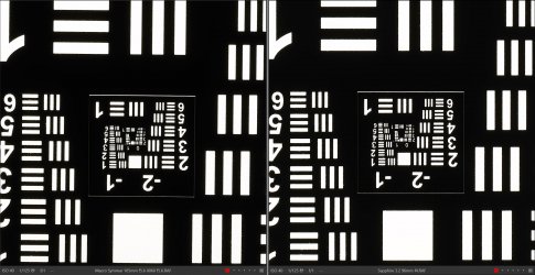

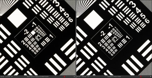

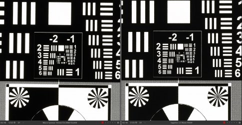

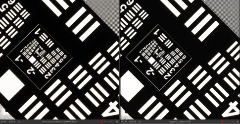

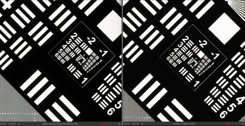

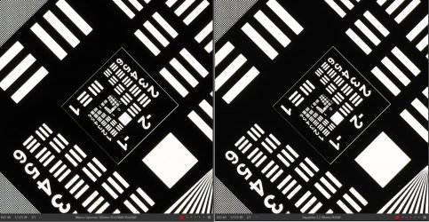

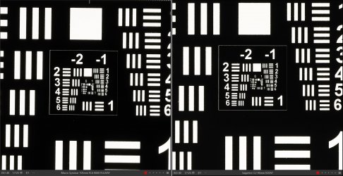

Just got Schneider Macro-symmar 120mm f5.6 0060 lens by Aliexpress from China which is optimised at 1:2 when aperture fully open.
mount on automatic bellow using 65mm to Hasselblad V adapter, captured by FUJIFILM GFX 100SII with Hartblei V mount to GFX adapter.

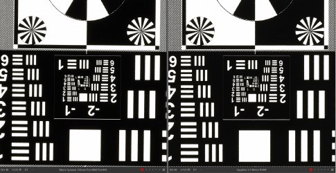

Test result is excellent, nearly no CA at corners and very sharp from central to corner. it is much better than Hasselblad S-planar 120mm f5.6.
I attached tests as below, edit with capture one without sharp, captured at aperture fully open @f5.6 1/125 Iso 40, light source with Elinchrom strobe
This lens is not expensive.
lens itself cost £270;
M65x1 Thread to Hasselblad V Bayonet Mount Camera Adapter Ring for Helicoids cost £21;
65mm-42mm M65 x1 To M42 X1 Female thread Camera Lens Mount Adapter For Helicoids £13
M65 to M65 Mount Lens Adjustable Focusing Helicoid 17mm-31mm Macro Tube9239 £24
V-M42 Lens Adapter For Schneider Lens V Mount Adapter to M42 £14

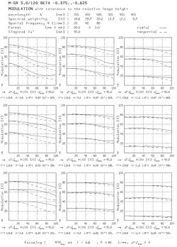

it is very strange, get two different MTF of Schneider Xenon Sapphire 3.2/96 0001 0.5X.
one has unbelieve 100l/mm 50% at central and corner;

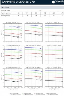

The Schneider Xenon Sapphire 3.2/96mm has brilliant MTF achievement which shown 42.5% flat @f4 @ 100L/mm, unbelievable.
MTF chart please refer link as below
https://schneiderkreuznach.com/appl...79/SAPPHIRE_005_05x_V70_1071189_datasheet.pdf

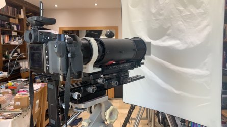

Sapphire test result looks little bit better, but it is so heavy and I need get some lens support it to keep it straight. I can’t mount it on the hasselblad autobellow due to its huge size and short focal length. It challenged me to keep parallel for the horizontal rig setup and prevent lens drop at same time.
To get the advantage of such high resolution lens, the rigid rig setup is essential.

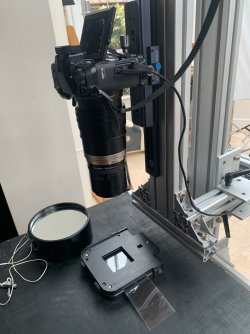

I tested with vertical rig setup also which I made by myself. The Anti newton glass of the film holder looked have some problem, it keep film flat, but I think it caused flare issue when I backlit by strobe with diffuser.
There must be long run to get proper accessories to take advantage of the lens.
Schneider Xenon Sapphire 3.2/96mm 0001 vertical rig setup
Using Mirror refer for alignment by adjusting four corner level screw
anti Newton glass 6x6 film holder
Elinchrom strobe lighting source under
I have checked Vlads target 120 film manual, it said the “The absolute resolution of the Type 120 and 4×5″ targets is 43 line pairs per millimeter.”
So I can't not tell which lens is superior using Vlads test target. Two lens all good to reach the resolution limitation.down central.JPG
My horizontal rig set up
From front to back as
Hasselblad slid copier with shade mount with auto-bellow geared extension adjustable rail ( which I dismantled the V mount adapter)
Hasselblad bellow extension tube 100mm X2 ( subject distance near 300mm)
Schneider Xenon-Sapphire 3.2/96mm 0001 0.5X hide into the extension tube prevent from flaring
lens support bracket
Lens adapted with Schneider V70-M75 0.75 adapter + M62 X1mm 30-60 adjustable helicoid adapter + M72 0.75 GFX adapter
Fuji GFX 100SII with Elinchrom Skyport Speed Sync
Shot @ F4 ISO 40 1/125x ( highest Sync Speed)
10 sec timer and Stabilization OFF
