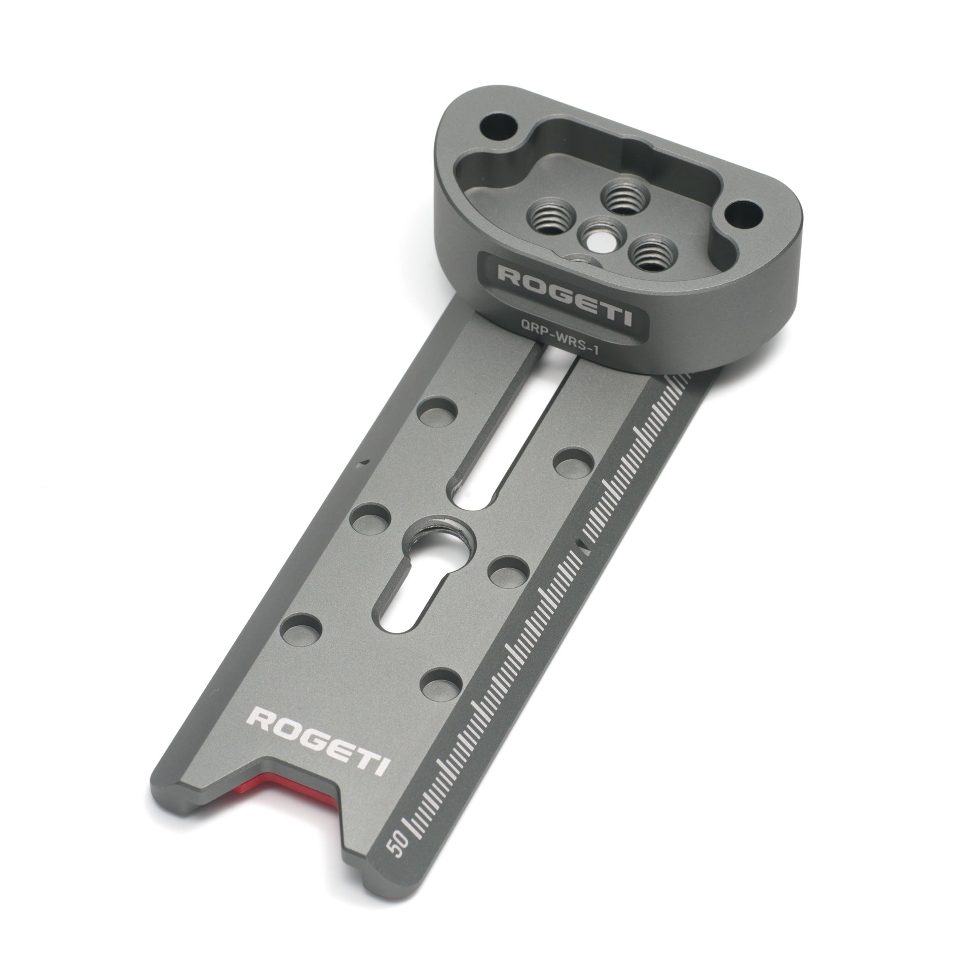

I have one question: The tripod socket is quite small, which Arca-Swiss compatible plate would you recommend?
I know that there is the WRS-145 alternative, but it's rather pricy.
Thank you!
Yes the WRS-145 is indeed a little pricey (and also adds some bulk), but the extension of the foot below the body of the camera allows for full vertical shift. If you decide to forgo the WRS-145 and use a simple A/S plate, check to make sure that it won't get in the way of the rear standard when it's shifted to its limit.
John
John
I was thinking to use the existing tripod mount that leaves the room needed for the movements of the camera and attach an Arca Swiss plate underneath. Basically I could find plates that have a stopper on one side, but unfortunately not on both sides. I was wondering if there is a plate available that fits entirely. If not, then I think a small metal stopper that could be fixed with a 1/4" screw would do the job.
I use this on my 1250.
That's pretty cool. While the long-ish rail/foot might come in handy e.g. as a nodal rail, it might otherwise get in the way. Do you happen to know whether the block is compatible with their QRS-R14 square plate? If so, this would make the entire package quite compact.
John
Hi John,
I don't know if the QRS-R14 would fit. Assuming the plates are of similar width, it looks like it should. I have just started building my system, so I can't tell you definitively that there is no interference at all. With the fall on the body set at 25mm there is still 3-4 mm between the plate and the bottom of the frame and 13mm to the bottom of where the DB will be.
Trevor
