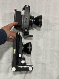

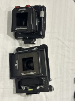

so when I use a longer lens like the 90 mm techno is much better for transport than the cambo WRS system. The small sliding back dont really make the techno bigger.
If I would add the compendium the techno system will be even smaller, as Cambo WRS compendium is really large compered to Techno compendium.
So the size and weight of such systems are not much different.

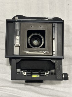

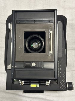

Thanks for the pictures Alkibiades! The sliding back with rotation looks very nice and compact. Is it possible to have the back in portrait orientation and do shifts? Would be a bad oversight if it wasn´t..
Edit: I guess I can see that already. The whole plate the db is mounted on can be turned, so it is possible. Nice!

Ah yes, I tend to use medium and longer focal lengths. If I want to get a very wide field of view, I can alway do cylindrical panos. But I do have a 20mm lens, then from 47mm up, wich leaves me with a gap that will be closed by the time I will get a smaller tech cam and db.
The Pico though... it still looks very very good! But I think the Techno is a viable option for me. And I find them regularly on the used market with quite acceptable price tags. Already! I guess the price will not drop dramatically any more at this point but that's fine.
