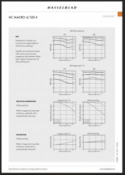

When it comes to macro, I’ve been using the Hasselblad HC 120mm 1:1 for about ten years. Slightly stopped down, it delivered truly spectacular results. In the GFX system I’ve heard very good opinions about the Laowa 100mm f/2.8 Tilt-Shift Macro. Have you had any direct experience with this lens?
