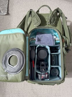

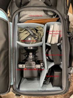

I currently use the PGYTECH OneMo 2 35-45L. I chose this backpack because I thought the squared configuration of the lower part would be perfect for housing my Swebo TCS 20 with several modifications I had made that make it smaller and more versatile.
The upper part allows me to insert up to 3 lenses, small flash, various accessories and the 907x with the TSE-17 mounted. The battery holder with the charged/discharged selector is also very convenient and helps me keep everything organized.
In the photo you can see how I organized the entire interior with the padded dividers.
However, I'd like to compare notes with those who use technical cameras to understand if there are even more functional solutions or particular arrangements you've adopted.
Thanks in advance for any suggestions and photos you'd like to share!damianomartinoPGYTECH_OneMo_2.jpg

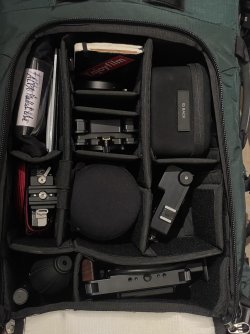

ALPA 12 STC outfit in NYA-EVO RCI-L - camera, lens, digital back, ground glass adapter included.
Backpack is a NYA-EVO 60, which allows to carry a few more lenses and accessories.

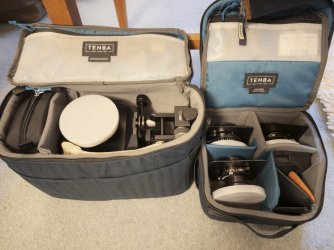

Different setup for 4x5 and 8x10 film cameras. Here I prefer to work from the Tenba Car case or (for 8x10) a Profoto padded case sold for the ring flash reflector. Lenses packed in Stone Photo Gear or Gnass lens cases. All of the above I sometimes load on a beach trolley with extra large wheels. This of course limits my movements to relatively even ground and short distances - ideal for scenarios where I know what and from where I will be shooting (I shoot mostly old factories - link here - so this works for me). Alternatively, my Linhof MT2000 and a few lenses, 2-3 filters, 5 film holders, loupe, cable releases and a spot meter fit neatly in the wonderful Compagnon Element 30L backpack. I sometimes pack a length of bubble wrap or an old towel (attached from the outside) to lay on the ground under my pack to prevent it from getting dirty (if I suspect that I will have to put it on the ground to get access to my equipment).

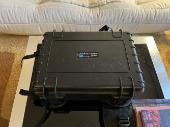

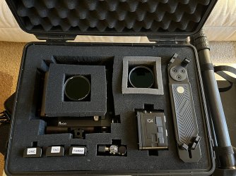

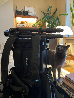

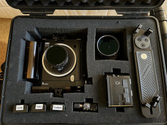

My most compact setup measures 37x46x23cm and weighs in at 11Kg. I always use hard cases, and this particular one has been outfitted with a harness so I can carry it while riding my bike around town. I made extra foam cutouts to protect the lens mounted on the tech cam and keep it snug. For this compact setup, I only need to carry my two favourite lenses, as you see both of them have the extra cutout. The tripod is fastened to the harness and rests on top of the case. I usually only carry two lenses when I photograph 'for fun'.
For more complex shoots, I have a bigger, heavier case that can fit all four lenses I own, including extra accessories such as a compendium and an iPad for live view.
My cats always want to be in the frame, sorry ;-)
(where is Soup when you need him)
I think we have exactly the same Tenba solution (at left) and backpack (Atrack 35). It works great.

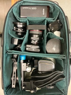

For work I'm using the Lowepro Pro Trekker BP 350 AW II.
  • Arca Swiss Pico (I keep the mount and bellows in the lid)
  • Camera body
  • 2 Canon TS-E Lenses
  • 1 Mamiya 6 50mm Lens
  • 24-70 Lens
  • Tabletop tripod (it is surprising how much you need one of these)
  • Batteries, cards, flash trigger, charger, etc.
Lighting is in a Lowepro Pro Trekker BP 450 AW II. Lighting modifiers and stands are in a different bag. And the laptop will either go in one of the backpacks or I'll bring my briefcase. My backup kit stays in the car. My goal is to carry it all in one trip. Almost there.

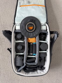

For fun I'm using a two different Shimoda backpacks. One is 35L I believe, and the other is 50L. If I am going out for the day I'll bring the smaller one, if it involves bringing camping gear then I'll bring the bigger one.
Here is the smaller one with…
  • Digital back
  • Arca Swiss Pico (One lens stays mounted and I keep the bellows in the lid)
  • 2 or 3 additional lenses
  • Filters
  • LCC
  • Loupe
  • Other random items
I can also fit a coat, food for the day, extra socks, etc. Whatever I need for a day hike. It has quite a bit of room and is very light when empty. I can fit a lot in the bigger one– tent, sleeping bag, food, extra clothes, toiletries, tech cam, digital back, 3-4 lenses, extra batteries, lcc card, etc…
When I'm working I leave everything set up and carry it that way. When hiking I carry my tripod and set up/break down for most every scene, unless I don't have to move very far. In that case I just carry the tripod with the camera mounted to it.

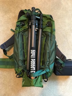

My normal setup is Shimoda Explore 40 with large ICU. I almost always start with my camera setup with what I anticipate starting to shoot with. Part of this is from the habit of shooting at the beach where I try to never setup or break down my camera once I get there. The Shimoda is a deeper backpack which works well for the way I travel with the camera already configured. Also, typically there will be protection above, below and on all sides of my camera/back/lens. I also travel with a RRS TFC-34 and Arca-Swiss Cube. In total normally around 30-32lbs.

Pieter 12's image is a good inspiration. I found a way to fix mine on my old backpack.
