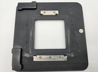

I bought this adapter on eBay. It’s coming from Japan.
What else do I need to get the CFV 100C working with the GX680?

The digital back adapter arrived. All is well with getting the back on the camera.

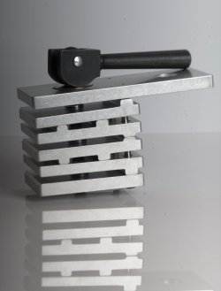

This is the first photo. I didn’t even get flash going. Just a modeling light, so forgive the exposure. I’m no pro. Just a guy that likes to tinker with photography.

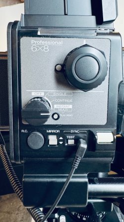

I’m coming up on a small problem. After I take a photo, the BATT OK green LED and amber WARN LED flash alternating. The shutter is cocked, but I can’t take another photo until I power cycle the camera.
This is true in either position of the back adapter, and either position of the main camera switch (single, continue).
Any ideas on what I can do so it will take a second photo without the power cycle?
Steven M
Of course the solution is right in front of me.. for anyone else that may run into this, there is a small interlock button on the mode selection knob. It slides away from the body, allowing the knob to rotate past the CONTINUE position into the CONSTANT position.

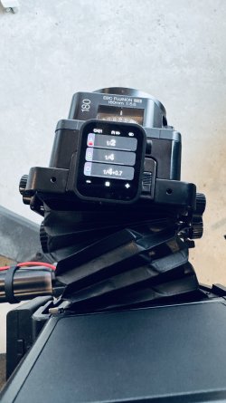

Once I had that sorted out I was able to get the flash working without any fuss. Using a Godox trigger.
This all just plain works!

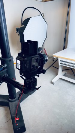

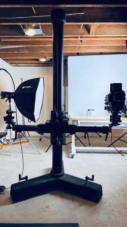

The setup
This is all for product photography for my electrical testing tooling that I make.
