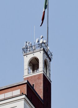

Stopped down the lens is perfect across the frame, of course with no CA especially in difficult sun lit reflective white surfaces, which is quite impressive. That's F5.6 shooting a building from the hip, top corner.

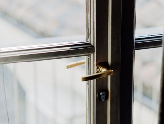

It's rare that I find a lens that never produces chromatic aberrations, and there are some on the window pane visible (with close-up view of the handle).

It is very low comparatively - I know my lenses and I didn’t say this one has no CA; I said it has a pleasing CA with more green tint aberrations and that it’s quite well controlled and only visible in extreme scenarios.
It’s gone once you stop down and not even visible at 2.0 if you don’t have extrem light dark contrast. Really top class for 2.0 and an in view of this large image circle.
Oh, yes, I see now, sorry I missed that. Yes, agreed on the CA performance from those lenses, that's a quality result.
