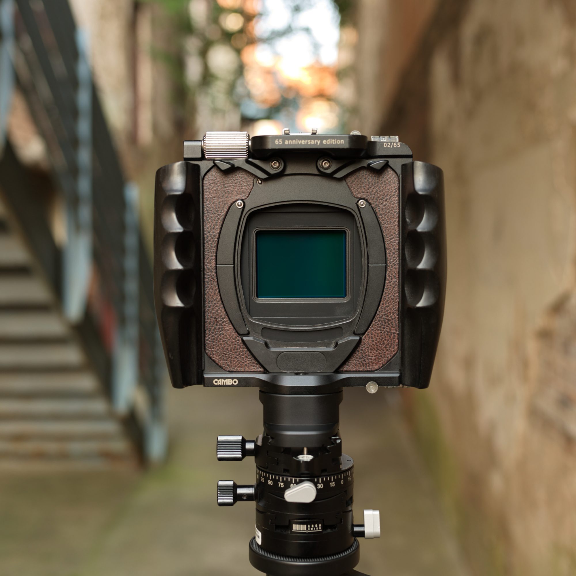

Dave’s prized #2 65 Anniversary Edition WRS 5000 (Not for Sale!)

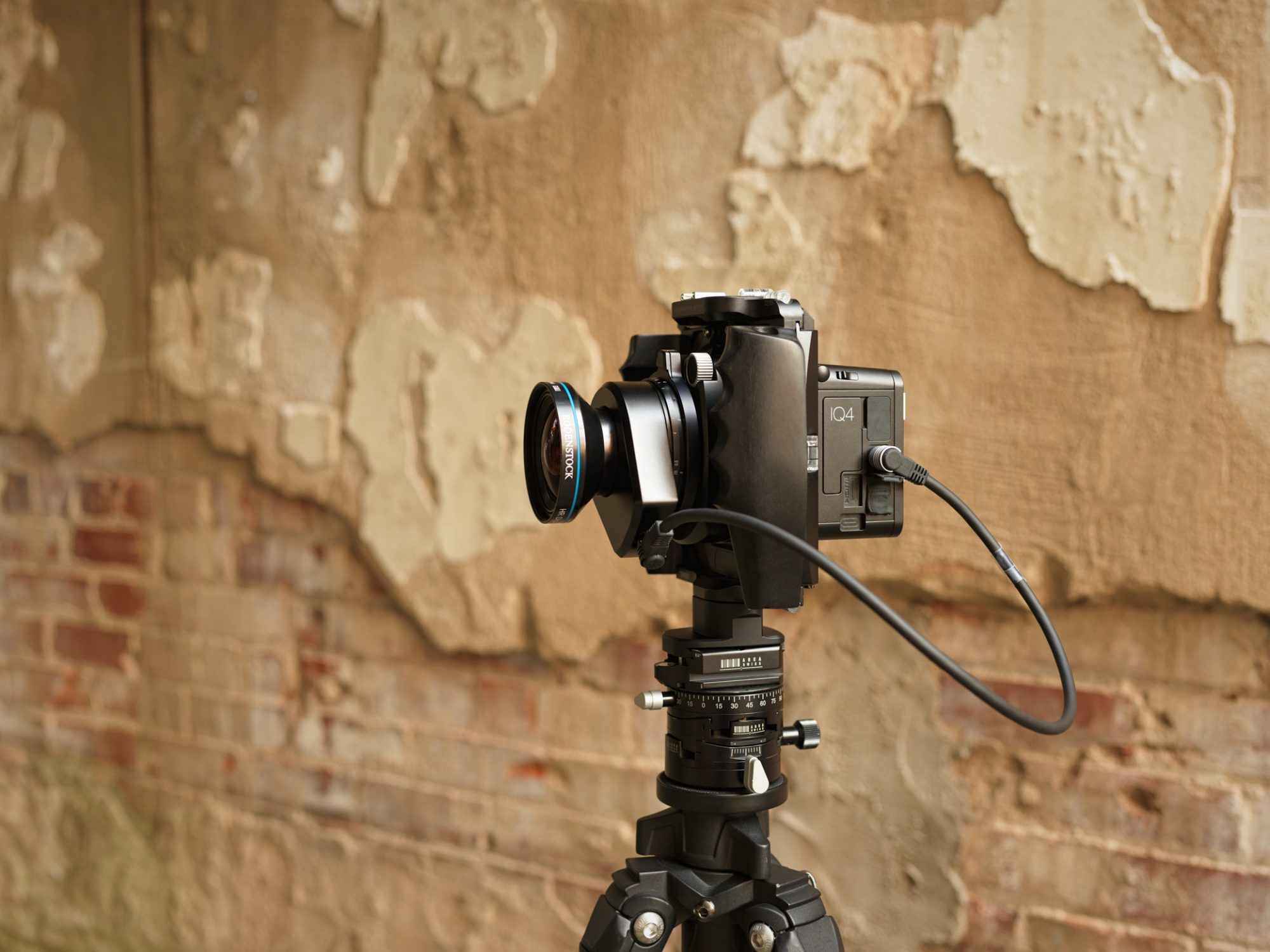

Yes, with the Cambo there’s a cable. But all X Shutter lens operations can be controlled from the IQ4.

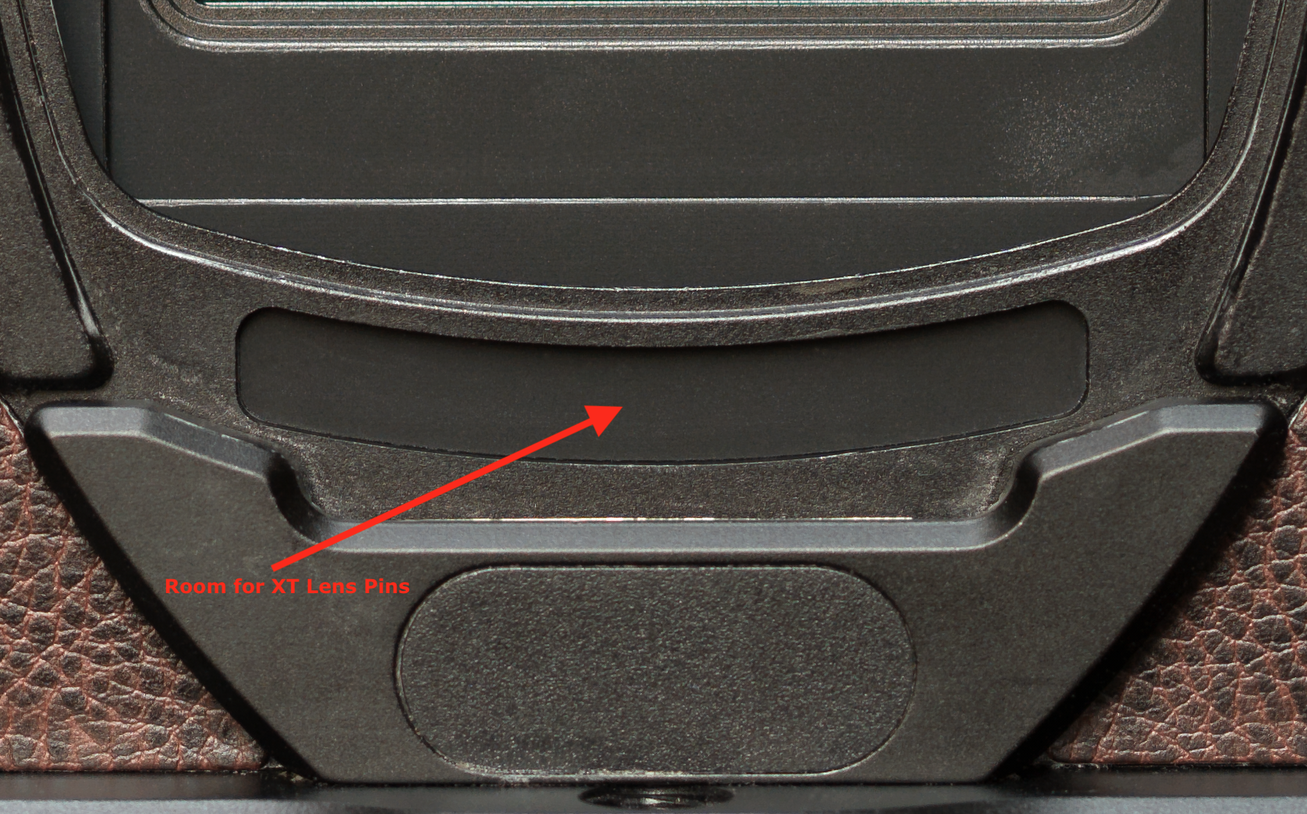

So why not add a Cambo WRS/WRC body to your existing XT system? Have photographers ever relied upon only one camera? (rarely) If you already have a Cambo body and would like to modify it to accommodate XT lenses, this is done easily enough, the cost is $528 + shipping. Please contact us and we’ll take care of this process for you.
