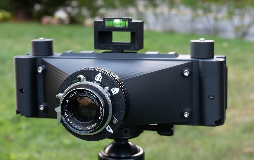

Here's a fun shot of my setup with my first negatives:
Malefic 6x17 Triplet 3D printed camera
by Graham Gibson, on Flickr
I have a clip-on lens for my smartphone that I realized I could use as a viewfinder and meter instead of the plastic one it comes with. I designed a tiny 6x17 mask on my own 3D printer--you can see the lens clipped on the level in the picture above; I just put it on my phone when I head out and it gives me a pretty good approximation of the framing.

As I mentioned earlier in the thread, I found the viewfinder to be inaccurate for precise framing (too wide). My solution is using a cheap x0.67 add-on lens for my phone to get pretty close to the correct angle of view (it has IBM branding because I got it free at a conference a few years back!). I then designed a tiny custom lens cap for the add-on lens with 6x17 matting built-in to show the crop properly. Mounting my phone on top of the Malefic gives me a "pretty close" live viewfinder, which additionally I can use with a light meter app to get the correct exposure settings. Another benefit of course is that I only need to bring out my phone to scout images.
