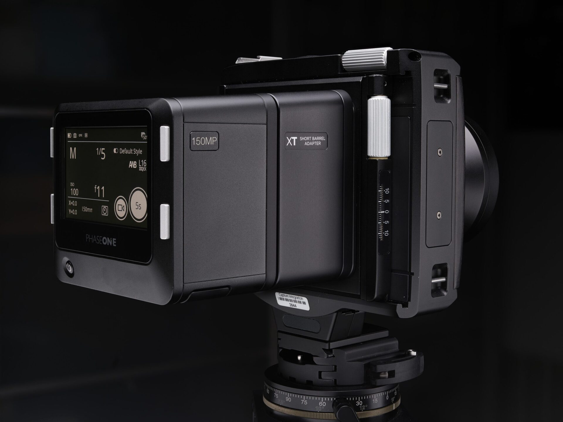

Don't know if this XT version short barrel adapter has same thickness as the Cambo SB lens rear spacer. If yes, we can buy SB version 138HR as the ultimate mid-range lens option and wait for XT XL for larger shift capability.

A bit weird, but then again – this is a smart adapter costing more than 1k to allow for connectivity. Besides the 90 HR and maybe one day a longer tele, not sure what else this is useful for except if P1 releases a whole range of lenses ...
I wonder if it would work as a macro tube for the XF with an IQ3 back, lol. Is it passthrough, which would work, or literally “smart” as you say with a microcontroller (which would allow exif and checking if your setup is correct!)

The technical impediment to providing longer lenses for the XT has been that the XT cannot accept the Cambo WRS rear spacers (such as the 48mm rear spacer WRS-1048 used to mount the SB mounted RDK SW 90mm lens).
In response, Cambo introduced the WRS-1049 front spacer, which is very high quality and works well except that it slightly vignettes the image on large shifts. At least that's what I found when I mounted and briefly tested two other 90mm lenses (the SK Super-Angulon 90mm 6.8 and the RDK Grandagon-N 90mm 6.8) using the WRS-1049 on my WRS 1200. To avoid vignetting, the extension required by the lens must be on the rear.
We're not being told the depth of the XT Short Barrel Adapter, but the lack of a depth in the name suggests that this might be intended as the standard rear spacer for a range of longer lenses using newly developed telephoto designs.
The rear spacer for this new lens does make me believe that Phase is planning on developing more lenses as well. Very interesting. Hopefully, this new rear spacer is 48mm like the standard Cambo rear spacer and new lens designs will be compatible with the WRS system.
