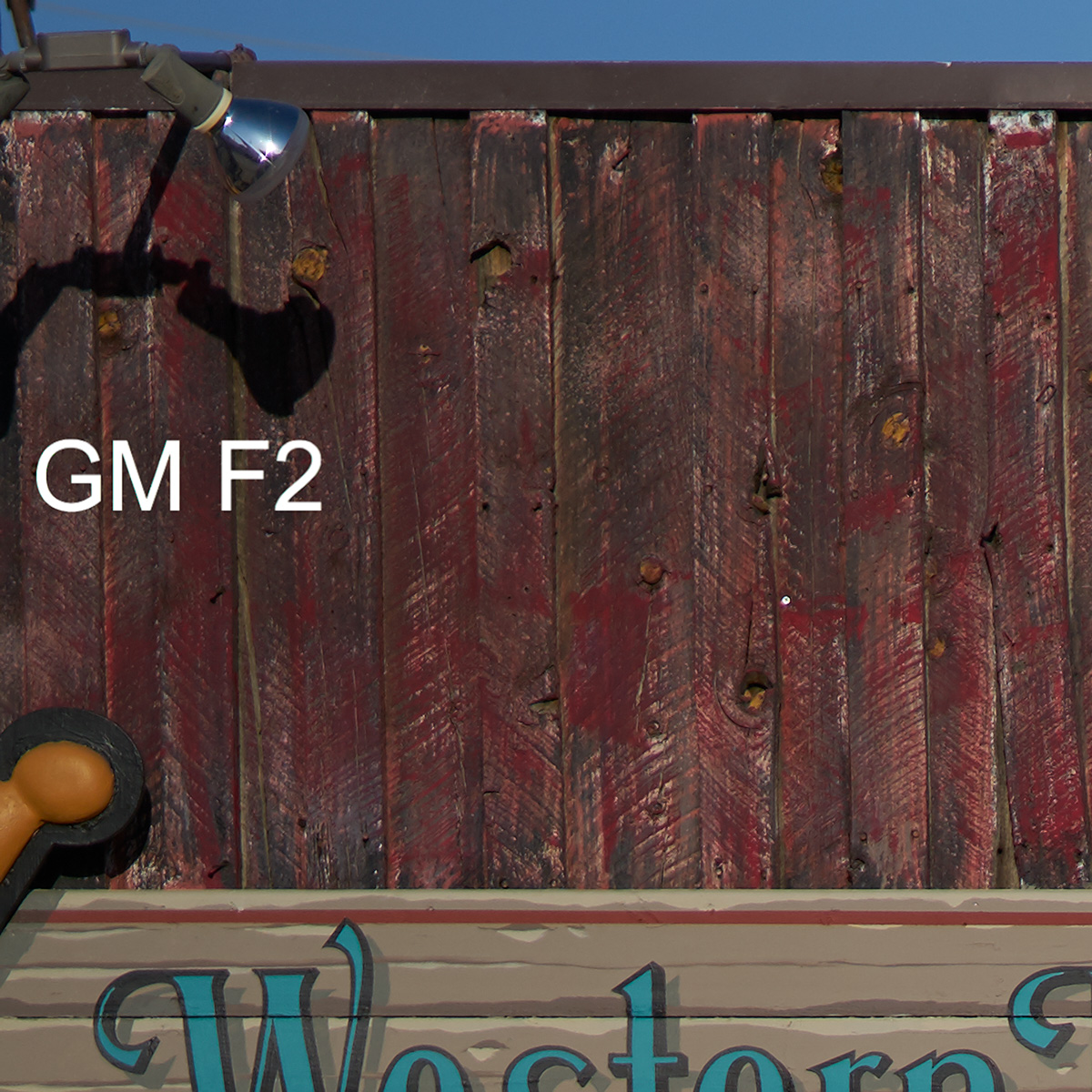

Okay before we get into the direct comparisons at same aperture the GM 85 has several stops of speed so lets look at the upper left corner.

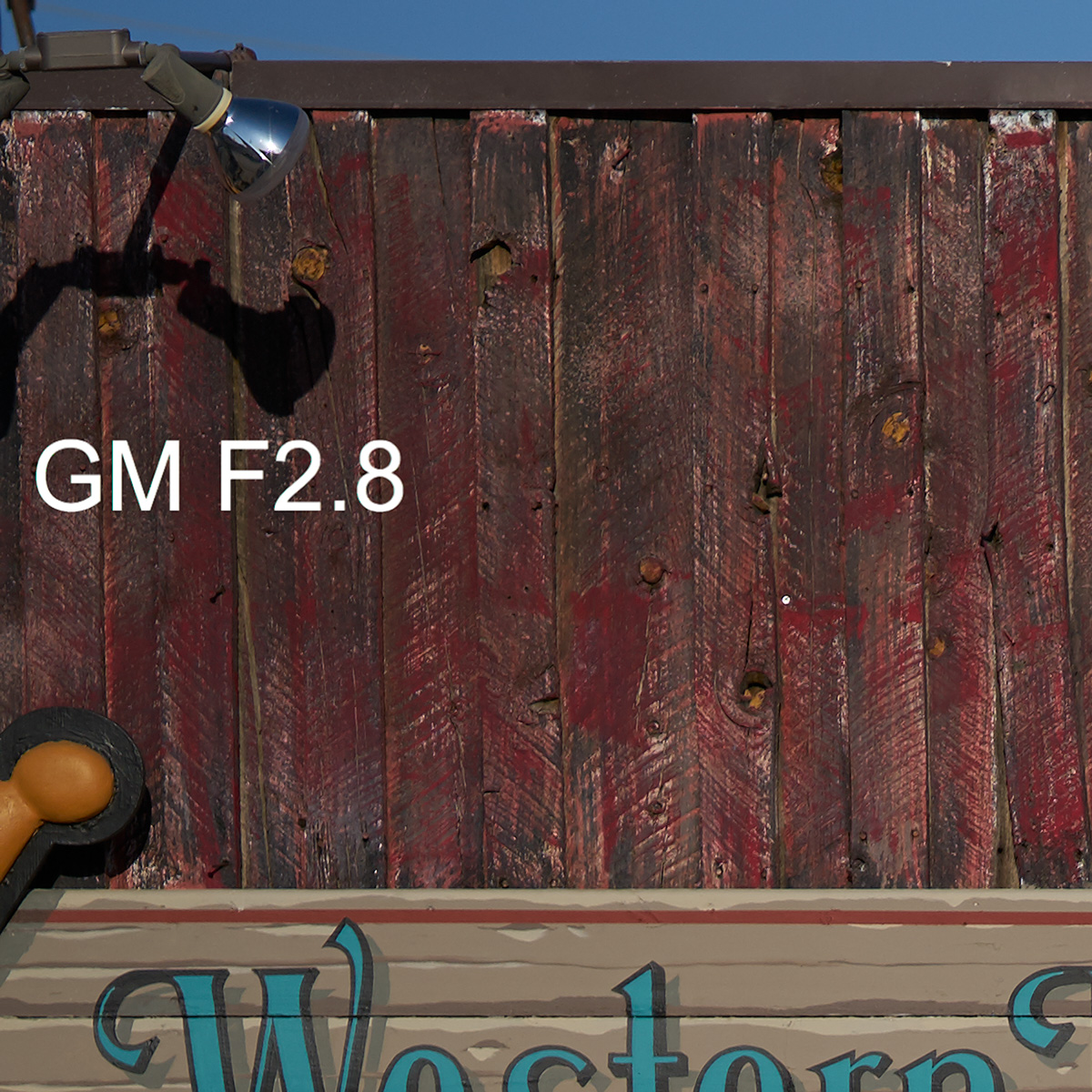

Okay lets get into o the direct comparison but as you can see even at 2.8 the corners are really coming alive

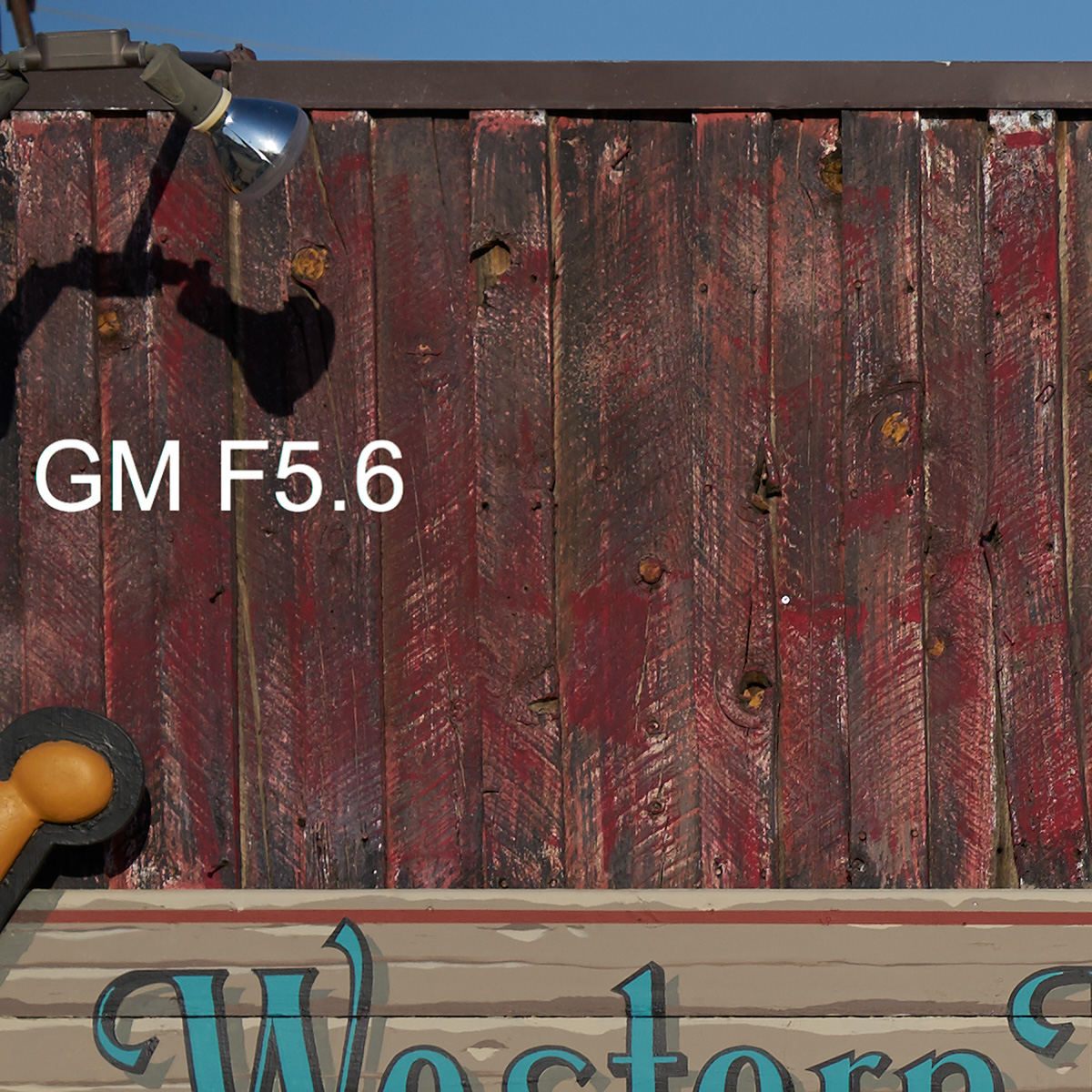

Okay starting at F4 the direct comparison of upper left
So that is the short range test. Im about 35 yards from the wall. If you notice the ZM is a touch wider than the GM, it does have a little CA at F4 but easily to correct and gone by 5.6. From my seat at F5.6 I'm actually going to give the ZM a very slight edge. Folks thats really freaking good to even be in the same park as the GM 85. If you look close in the light bulb you can see the CA at F4 gone by 5.6. For landscape work this is where you start with aperture

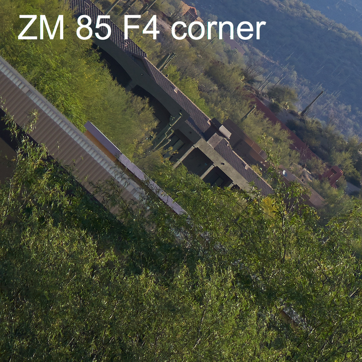

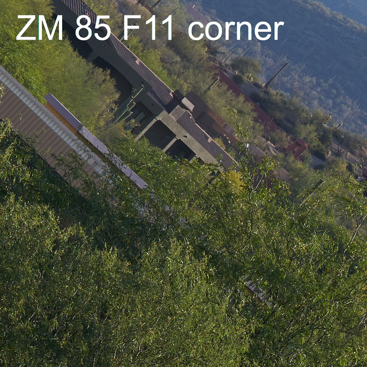

Going to show a quick shot of the upper Right on the ZM 85 at F4 just to show I have no lens issues and I'm well centered

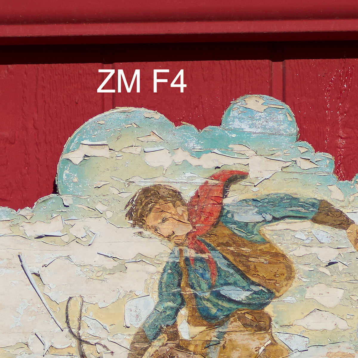

Quick center test of another wall
Need to remember here the ZM is wide open here at F4
