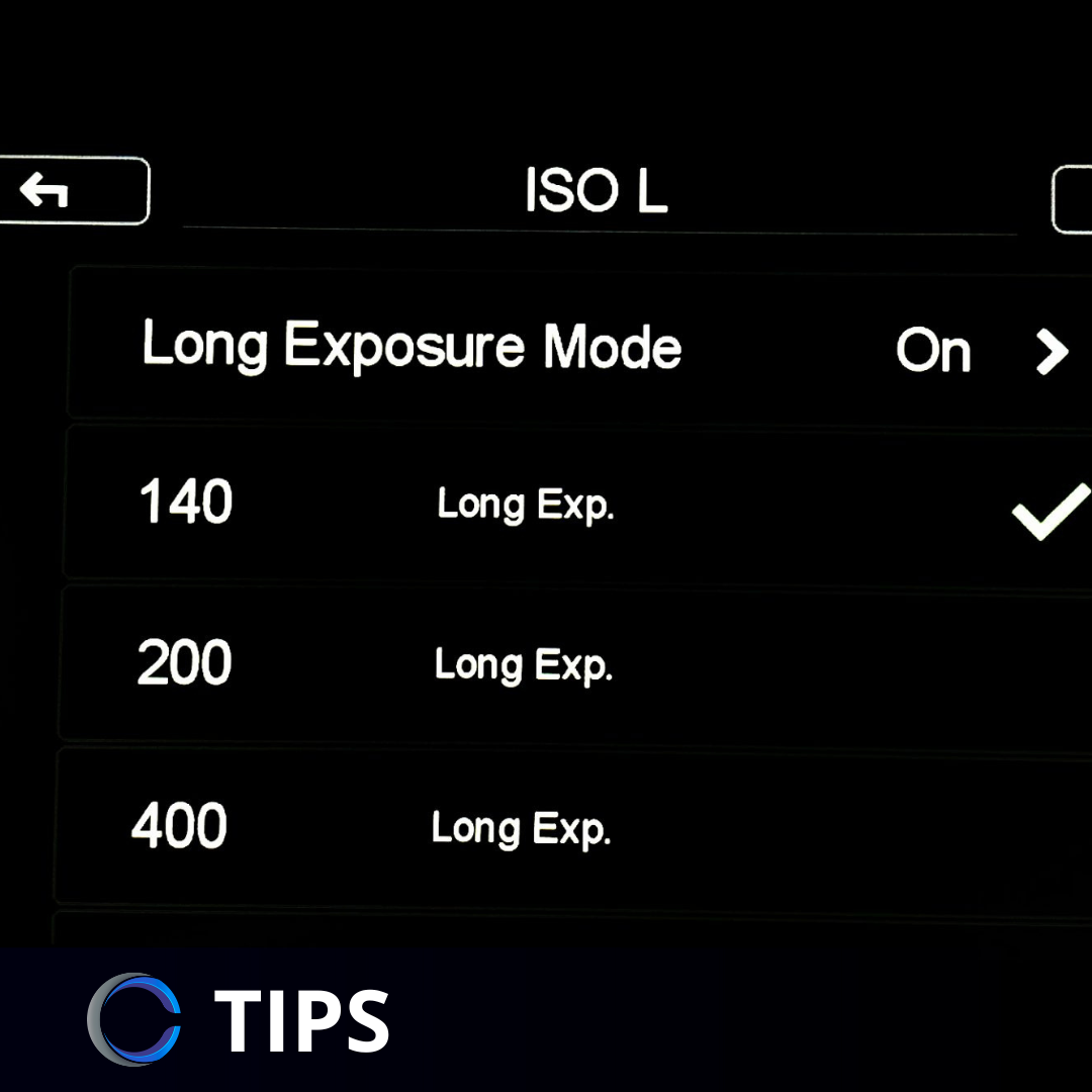

The 60mp and 80mp digital backs from Phase One initially provided good quality long exposure for one to two minutes. This changed for the 60mp model with the IQ260, which allows that same quality for much longer periods of time (at least 30-40 minutes). The 80mp models did not acquire this ability until the IQ380.
So when it comes to long exposure, for best results:
IQ160 - one to two minutes max
IQ260/IQ360 - much longer, 30-40 minutes or more
IQ180/280 - one to two minutes max
IQ380 - much longer, 20-30 minutes or more
As always with long exposure, YMMV (depending upon ambient temps, etc).

On the IQ3 and IQ4, there's a setting to enter in your ND filter value and the back will adjust the exposure for that. Less necessary on the IQ4 if you're using frame averaging.
