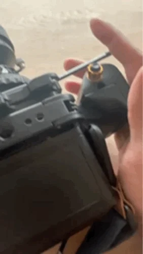

The key was the fact that you can attach the shift sticks to the HPF rings – it is a little known thing about Alpa. This allows you to nudge the helical while holding the grip at the same time – essentially allowing one to focus quickly. easily, while handholding the camera and looking at live view. If you use a wide angle around 40 or below and just go to f11 and hyperfocal you don't even need to worry about focusing and wobble is also not a problem if you stand still.

Do you have a shift stick attached to the lens?

Paul, is your question is directed to me? No I don’t have a shift stick. I don’t have an Achromatic back either, though I do have an IQ3100, but no trigger wire, will attempt to try it out later today.
Yes, in case you can get hold of one (they are not too expensive) it is worth it because you can nudge the helical of the lens with the HPF ring while keeping your hand on the ergo grip - this in my view is a game changer for handheld shooting. Might post a GIF to show this at one point ... one can unscrew one of the two silver tips in the HPF rings depending on how you orient the lens vs. the camera. Really nifty and not well documented!

This makes it possible with IQ4 gen backs to quickly frame something in live view, "focus with your fingers" and shoot.
This allows for one-handed focusing and shooting.
