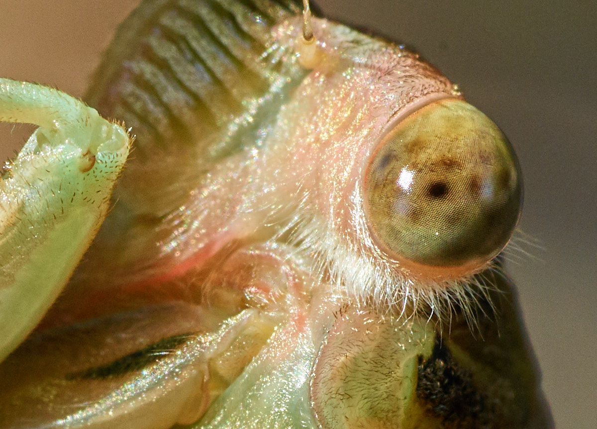

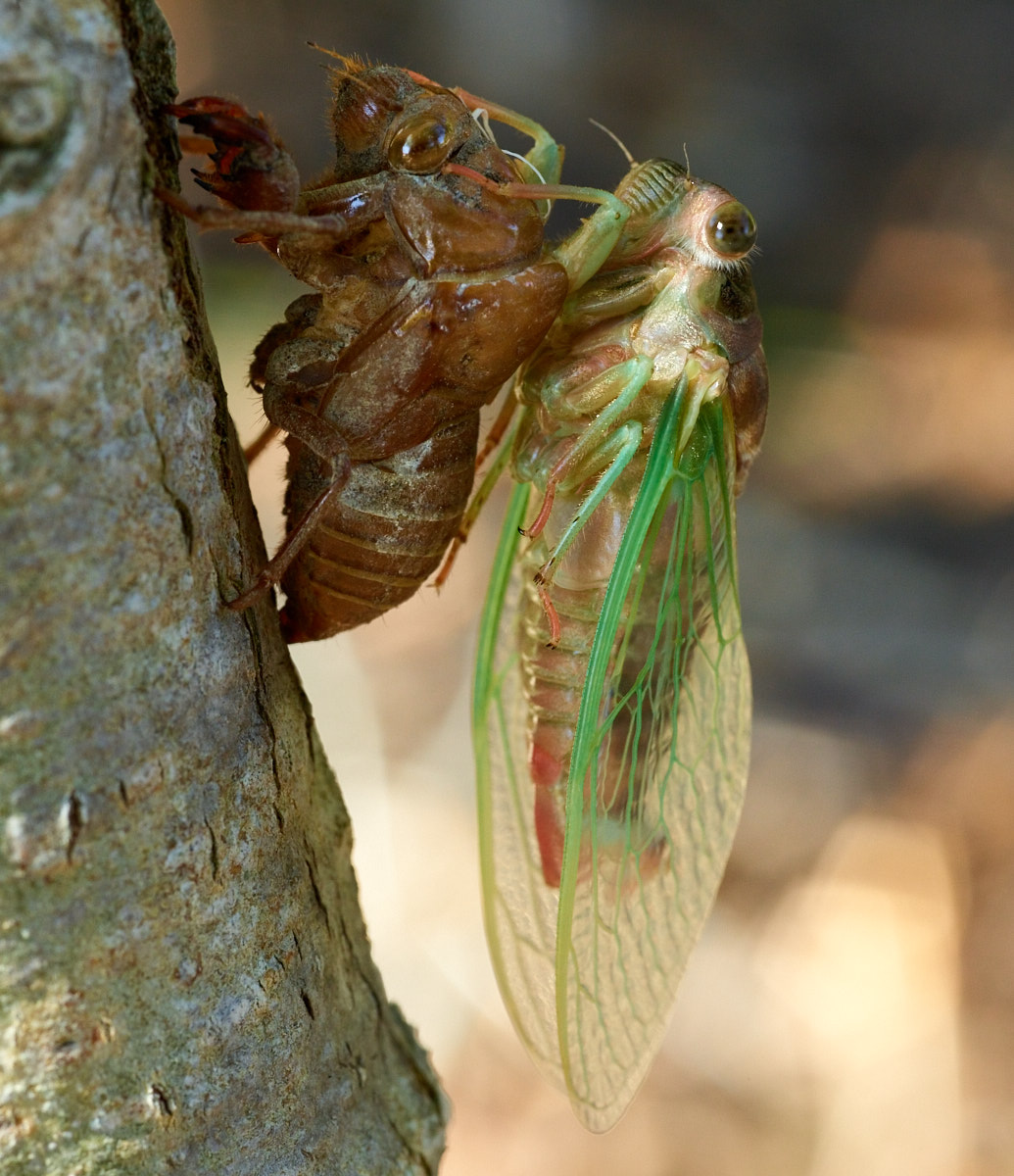

Bill Caulfeild-Browne
Here's the eye of a cicada. XF/100/120BR Macro. The bottom picture shows the full frame. The image is close to 1:1, as the Cicada is only a little longer than the vertical field of the sensor - 55 mm. .
