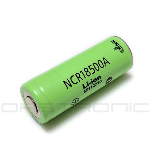

I was able to put a pair of Panasonic 18600's in my older packs instead of the older flat cells. It's been about a year and they're still holding up strong.
docholliday
I'm assuming you mean 18500? If so, those would be lower capacity than the originals as most are 1500-1600mah.
